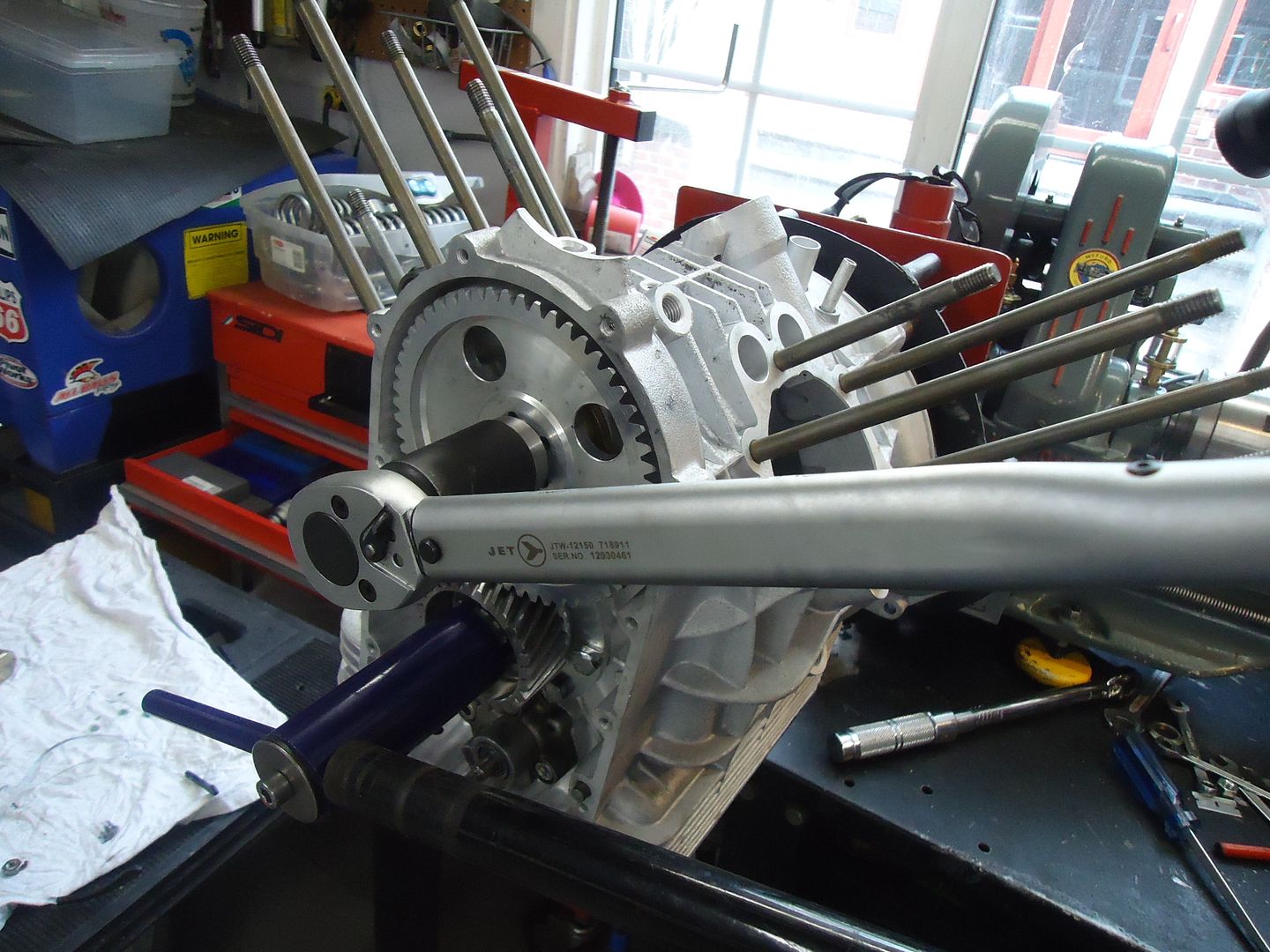

I spent most of the weekend in the office, damn work keeps getting in the way of important things, like engine assembly,
I got a couple hours in this afternoon,
Stripped and cleaned the oil delivery pipe and pressure release valve
My home made pressure tester indicates valve opening at just over 55 psi, within spec so that's good
I re-measured the oil pump.one shaft is good, the other one is just a couple thou under so due to no new ones available I am going to use this one and fit a pressure gauge, worst case I will need to replace it but |I can do that with the engine in the frame, I used a liberal pasting of assembly lube on everything that rotates
In goes the pump. pick up screen and oil tube
I salvaged all the sheet steel tabs and had them zinc plated
Bend over and peen the lock tabs
I measured the cam I got in the mail this week, it checks out to be a B-10, consistent lift on all 4 lobes, a coating of assembly lube
Some locktite and shnoor wwashers
Cam is back in with a new thrust bearing
Alloy gear set goes back on with new hardware
A brass rod machined to the small end bush diameter safely hold the crank in place and the special tool is bolted tight to the crank shaft end
Torque the crank nut on and bend over the lock tab
Then fit the cam sprocket, align the marks, hold the crank steady and torque the cam shaft nut
Lube the cam followers and drop them into the block
Install new base gaskets and O rings at 6 and 12 o'clock
Heat the pistons, fit the pins to the rods and install new clips
Oil the piston and rings, Compress the rings
Drop the cylinders on
That's all for now, waiting on heads to come back from the machine shop

I moved the engine over to the lift but first I bolted the engine stand down to the lift, almost tipped the last one over by mistaje and I don't need to risk that again.
Fitting the flywheel, I remembered to paint the end of the crank and flywheel before disassembly to be sure I reinstalled the flywheel in the correct position
New lock tabs and bolts and some locktite then torque it down to the crank
I don't know if this is good practice but I glued the clutch springs into the flywheel to keep them in position
Then fitted the clutch components
and then the plug
and that's done
