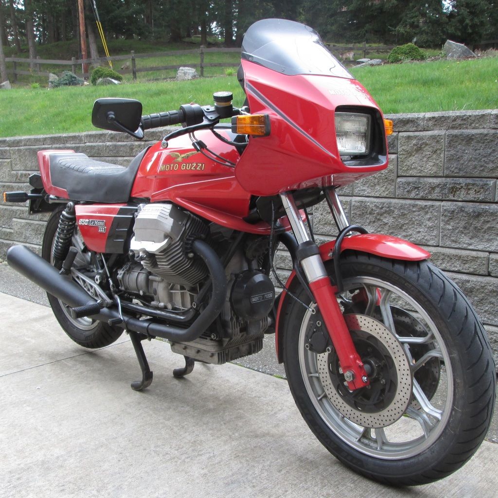

The LMIII still has saddles for handlebars cast in the top triple clamp.  Don't know if the later LMs are the same.  I put superbike bars on it and documented it over at Guzzitech.  (A flat bar won't allow the front brake master to clear the fork leg.)  This is a common mod and I got the idea from JJ who is on here.
http://www.guzzitech.com/forums/threads/installing-higher-handle-bars-on-a-lmiii.5923/#post-44552
The superbike bars are nice for everything except the freeway where they put you up into the airstream a little more.  The LMIII fairing must be designed for clipons at >70mph as the airflow is perfect with the lower bars (or ducking down with the higher bars).
The higher handlebars made the bike much easier to ride around town, looking over your shoulder in traffic and parking.
2 other things that made the LMIII easier on the wrists is using the lighter carb return springs and getting rid of the lever tops on the carbs (though you have to change the twist grip if you are going to get the last 3mm travel out of the throttle.  I used a slower opening Emgo throttle control.).
Picture before swapping carb tops.

Tonti Lemans will only be hard to live with if you do not carry out some preventative maintenance, easy stuff. I posted recently that mine is now so reliable that all i do is check tyres and go. It's a little tricky to start since i removed the choke but once warmed up it fires up as soon as you hit the button.
Here is the pic anyway in case others are curious.
1986 Le Mans IV Black Since New
2014 K1300 R Black German Starship.
