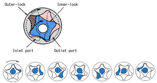

The pump is a trocoid type.
As far as I know, it will be pumping something like 2-3 gallons per minute maximum at 30 psi.

Re: How much power does it take to run a Convert fluid pump?
« Reply #29 on: April 06, 2016, 02:06:22 PM »
I have a theory that the atf pump does 2 things. One is it circulates the atf to run it thru the cooler. The second is, it forces the atf into the torque converter where the spinning of the TC wants to force atf out. In this way, it has to have more pressure forcing in than the TC has a tendency to expel. I'd bet that the higher the RPM the more the TC wants to eject oil, so the atf pump needs to have a higher pressure at high rpm. Luckily it is cam rpm driven, and so should up to a point produce more pressure at higher rpm. by going with a constant pressure pump, you have to scale it for the worst case, and at low rpm might be forcing too much pressure into the TC. Source of leaks? who knows... I hope not. Maybe that is what the 2ndary return to the atf tank is for.
