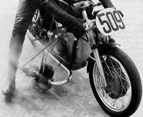

What could possibly go wrong.............. ................... ...........
 :cool:
Why you should always tighten your exhaust pipe clamps,....... to keep your cylinders from falling out.
'76 Guzzi T3   Future project
'78 Guzzi G5  Current project
'81 Guzzi G5  Organ donor
'92 BMW K75RT  On the road
HardAspie
And I had thought the rider was simply trying to reduce power as he came to a stop.
