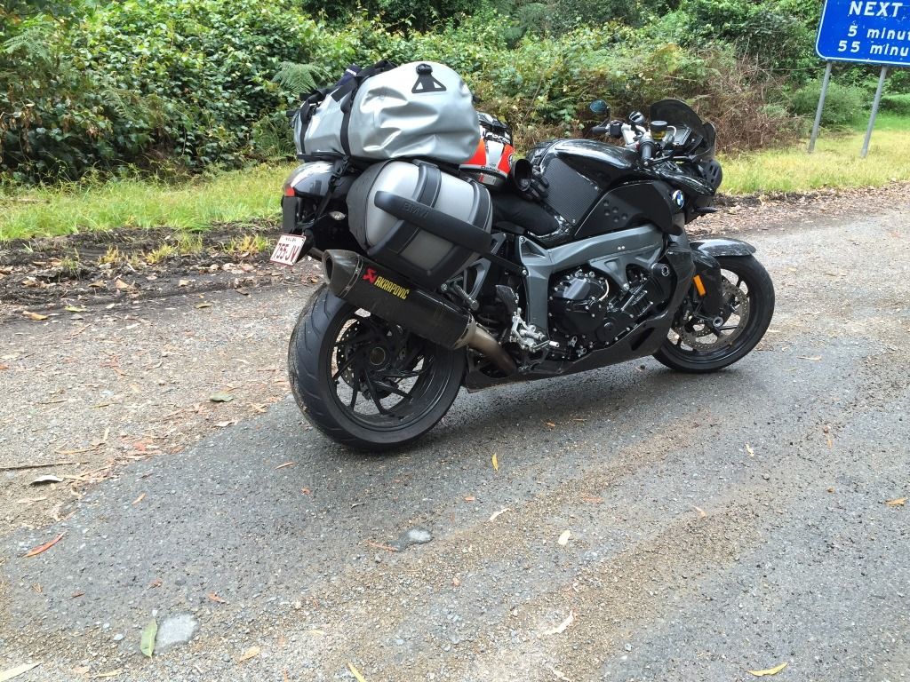

Thanks, i got an email from them. At $275 USD (about $875 AUD) plus postage i think i'll just take the German Starship on the road trip.
