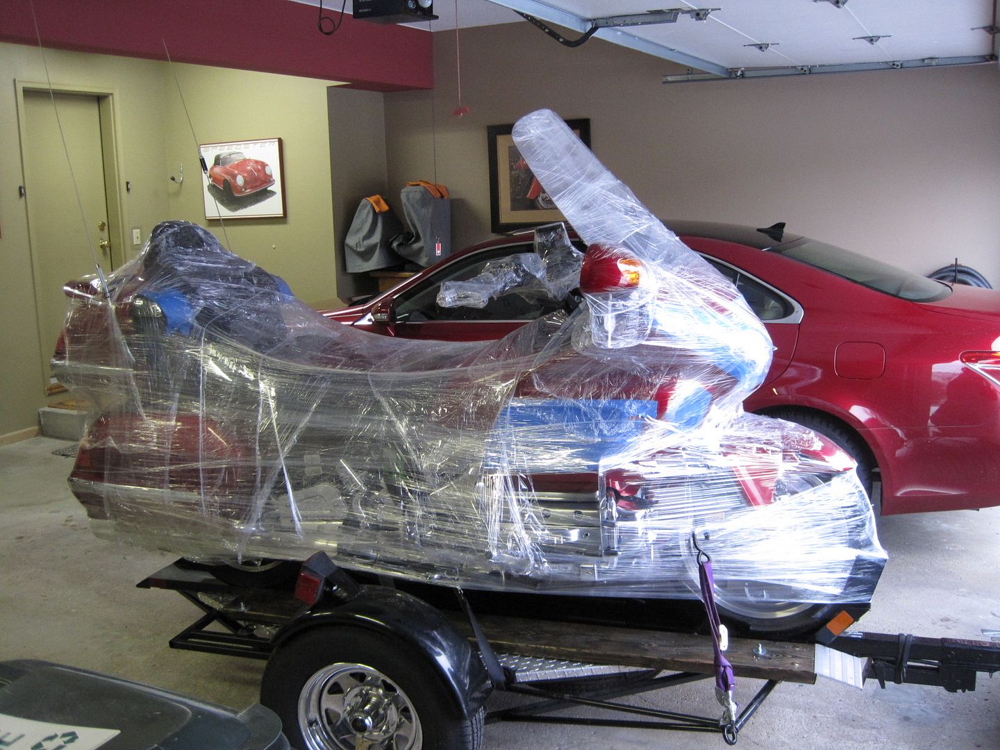

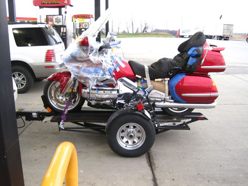

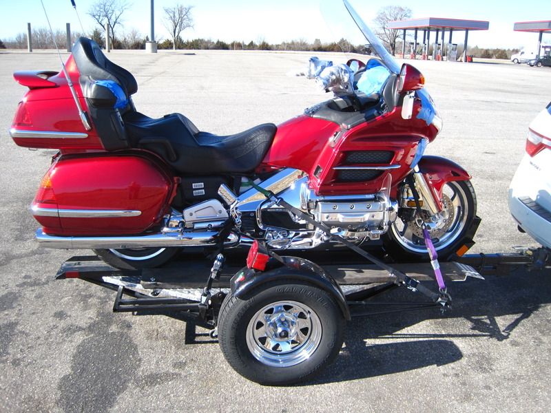

I just got back from dragging a bike to AZ for a couple of months and back.  Sure it got a little dirty but it cleaned right up.  Forget about wrapping...I tried stretch wrap and tape on the way out but it ripped off very quickly.  I used blue painters tape to keep stuff out of the openings.
Coming home I went thru no slush....dry roads for three days!  I did shrink-wrap the controls to keep the slop out of those.
This lasted for minutes...don't waste your time wrapping!
This is what it looked like 3 hours later..........
« Last Edit: March 05, 2016, 12:02:13 AM by John Ulrich »
