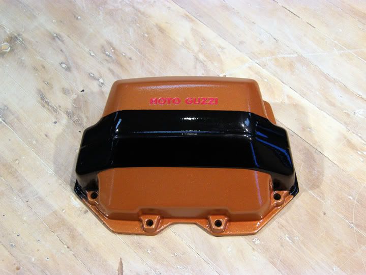

To directly answer -- almost any rattle can of engine paint will work.  The heat isn't bad on the valve cover.  Some folks use a primer like zinc chromate, or etch the metal before painting to increase adhesion.
That said, I sandblast and powder coat mine.  Here's a $10 rashed lid from a Jackal:
BMW in crinkle:
