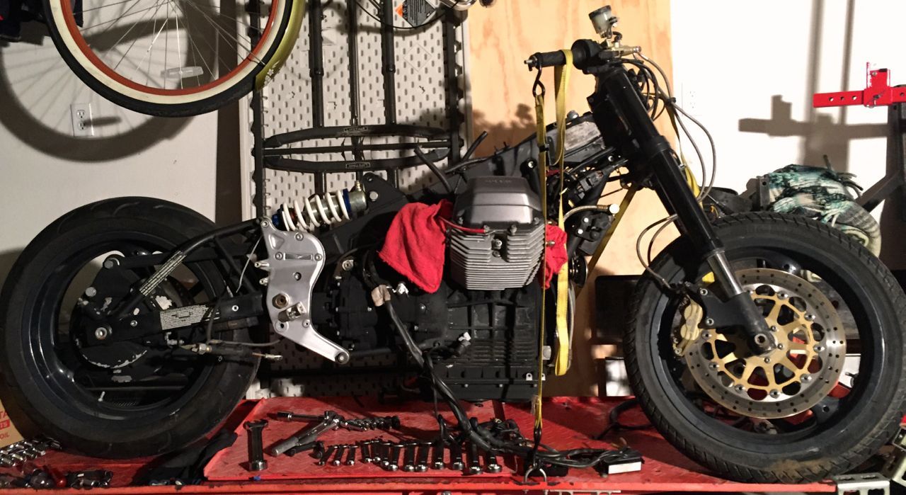

Here is (was) my partsbike - which was the same as the 2002 Red/Grey Lemans in the photos above. This picture shows the basic rolling frame/engine without the subframe that supports the seat and tail section. Although this one crashed hard and the front wheel is about a foot to the right of rear wheel
If you're going to learn about spineframes, you need to understand porkchops.
