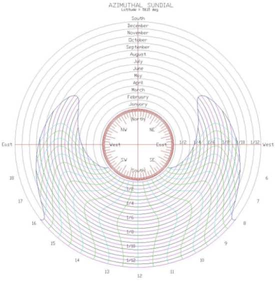

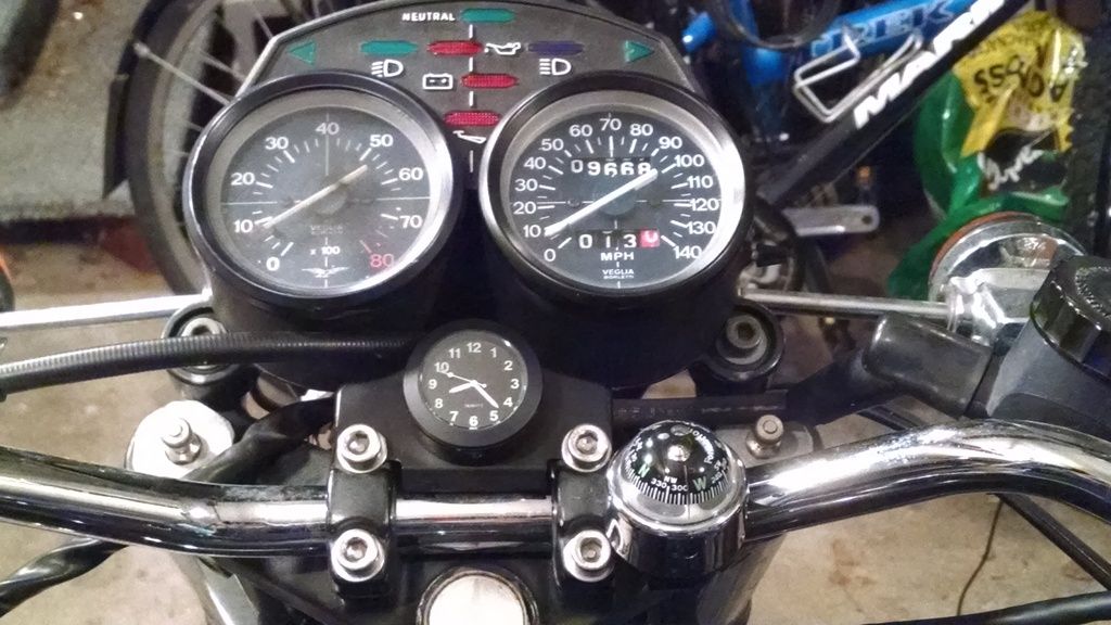

Great Moto!
I used their mount on the handlebar which elevates it away from the bar and the bolts for the bar clamp.
I figure I'll use the aluminum clamp that came with the little black clock I just installed, as mentioned in a recent thread. (Saving the $19.95 for Formotion's clamp!)

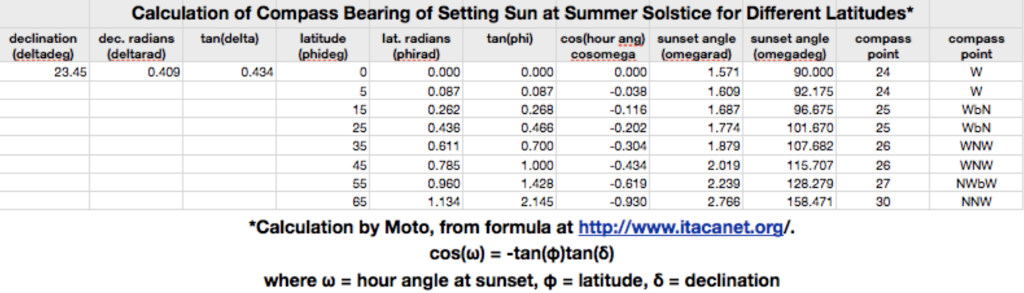

I'm sure you know this but I will mention that when traveling, the declination (magnetic) can cause errors in the areas your riding thru. So if your heading directly into the sun mid summer and the compass is 10 degrees off you are probably in an area of high declination.
Another thing that I keep in mind is that the sun is not always due west as it sets -- in midsummer it sets north of west. This plot shows the story (for 50 some odd degrees north latitude):
This can account for the 10 degrees you mention, apart from any local changes in magnetic declination. (I came across this particular plot while researching my sun compass.)
Moto
P.S. That plot is for a so-called azimuthal sundial, and is confusing at first, so I'll explain. Use the central compass dial to read the directions of the sun at different times of day for the different months. The highest light blue line on the left part of the graph traces the bearing of the sun at 6pm (solar time) for the different months. It shows the sun is about 15 degrees north of west at 6pm in June or July at that particular latitude. How the solar time corresponds to clock time is another part of the story. The topmost of the curved lines on the left shows the bearing at sunset, which occurs at different times through the year. In June/July the sun sets almost due northwest at that latitude.
The East and West notations on the outside of the plot, on the other hand, show how the (horizontal) sundial face should be oriented.

OK. I've got the Formotion magnetic compass mounted, calibrated, and working well. Here is my report. [Edited for length.]
The first photo shows details of the physical mounting.
On the bottom of the compass I found a 9mm diameter brass post, tapped for a 4mm x 0.7mm screw. I used the black, aluminum handlebar mount from my recent clock purchase by drilling its existing 8mm hole to 9mm, but only half way through (lower right). I had to buy a longer screw (25mm) for the clamp-to-compass connection, but otherwise it is great, and saved the $20 that Formotion gets for their mount. (The clock with its mount was about $13, I recall.) Also visible in the picture is a little non-magnetic adjusting screwdriver I made from a dowel and brass sheet to replace the execrable and flexible aluminum version that came with the compass (seen below it).
The second photo shows the final mounting position of the calibrated compass.
Location and calibration At first I mounted the compass on the handlebar up against the clutch lever, figuring that would put it away from the "great lump of steel" I perceived near the instruments. But it was impossible to calibrate the compass -- it would only point South.
So I used my free Android gauss meter app (https://play.google.com/store/apps/details?id=com.keuwl.gaussmeter&hl=en) and took measurements. First, I measured the field strength in the middle of my yard and found it was less than 0.5 gauss, the value that the Wikipedia article indicated applies for 50 degrees N latitude. (I'm at 43 degrees.)
Then I measured the field strength at my original mounting point near the clutch lever -- over 3.0 gauss. But another spot on the handlebar, right beside the handlebar mounting bolts, measured only about 0.4 gauss. I put the compass there and found I could easily calibrate it. (I had the motor running.)
The compensating magnets in this compass can overcome a modest field strength from the bike, but not one that is far in excess of the 0.5 gauss that the Earth is providing at its surface. I think using a gauss meter app might be a good way in general to position compasses on motorcycles. I was surprised to find such large variations in field strength at different points along the handlebar.
Performance I was able to calibrate the compass within two tick marks of each of the cardinal points (N E S W). This is within 10 degrees, good enough. I took a trip this afternoon and was very pleased -- using the sun and maps as my reference, I could see that the calibration held up on the road. The compass wanders over its heading while underway, but it settles pretty quickly so that it is not hard to interpret.
Quality of the instrument I took off the chromed brass case, hoping to see the "solid brass and stainless-steel construction for years of use" claimed on the website. The guts of the compass are made of plastic, though it seems well enough constructed. No doubt the manufacturer only meant to claim that what brass and stainless steel is present exists in the solid, rather than the liquid or gaseous states, and in that claim I can find no fault at all.
All in all I'm very satisfied. Thanks again for the recommendation, Kirby.
Moto
