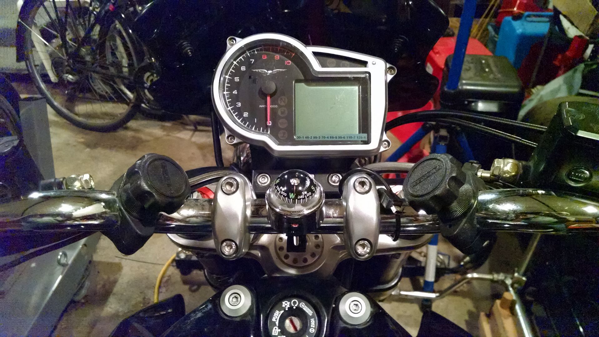

Thanks for the "tasteful" comment.
The compass is easily adjustable for variation, and suitable for the compass swing procedure that I've just been reading about. In fact, because of Kirby's earlier mention of having calibrated his compass (the same model) on an airport compass rose, I have located a recently-painted one at a small, unattended airport near me (Palmyra, WI) and plan to head there tomorrow or the next day for a swing:
As for deviation, I understand that is usually accounted for with a compass deviation card, which records what course to steer for a true heading of 0, 30, 60, ..., 330 degrees. The idea, as you know, is that the necessary correction can change for different courses.
I had been thinking about that issue too after reading up, and decided that a regular compass deviation card -- the kind I just described -- would be inappropriate for highway travel, since I can't choose my steering direction freely on a highway. But there is nothing to stop me from making at least an approximate "reverse" card, which would indicate my true heading for the indicated points 0, 30, 60, ... degrees on the compass. Since I'll be using the compass rose to try to a better job on the basic variation adjustment, I'll probably go ahead and make such a deviation card unless I get tired of repositioning my bike, or get chased away. Of course, there is probably little real value in doing this, and I have no expectation of posting this card below my compass as is done in aircraft. Enough is enough!
Moto
P.S. I don't know what a scissor magnet is, but would be interested to learn. The compass contains pairs of magnets on rotating shafts.
Moto
You say your compass is accurate to within 10 degrees which seems acceptable and a pretty good result considering the amount of metal and a nearby instrument cluster. This is just Gee-wiz banter.
Compass variation is simply the difference between true north and magnetic north in your locale. As you move away from your theater you will have to apply a variation correction factor in addition to the local calibration. Of course this is pointless on a motorcycle where you won't be too concerned about a few degrees.
Deviation is the compass error imposed by the local magnetic fields created by the vessel and the compass itself. Unlike variation this error isn't constant (i.e. add 8 degrees). Since the needles alignment with nearby magnetic fields change deviation varies with the direction of the vessel. Compasses that allow for deviation typically contain sets of magnets (scissor magnets) that allow for adjustment in more than one azimuth section. The compass is adjusted through the compass swing procedure and the remaining difference is applied to a correction chart. I saw the effect of this on a sailing trip where I bought a pair of used large speakers and stowed them under the cockpit. It made a noticeable difference!

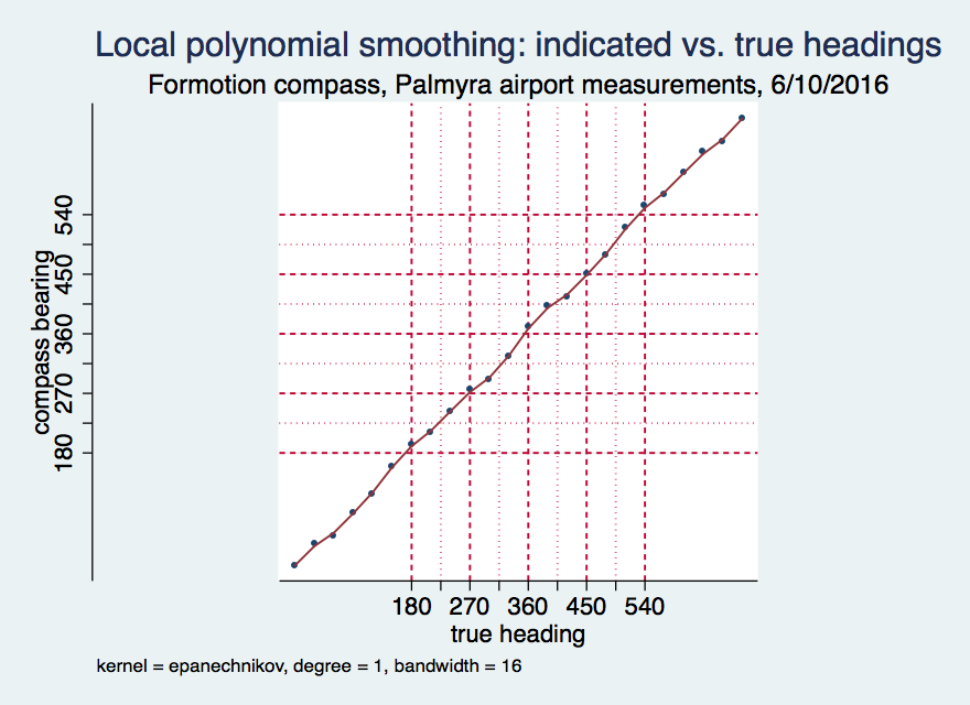

I did ride down to the airport compass rose at Palmyra, WI, to recalibrate my new compass today.
The short report is:
True         Compass    Compass
Heading    Bearing     Deviation
N     0              10        +10
E    90             90             0
S  180           193         +13
W 270           275           +5
Not quite as good as my initial report of +/- ten degrees, but close.
I did the full compass swing, as I understand it:
1. Point bike N, adjust compass to read 0 degrees
2. Point E, adjust it to read 90
3. Point S, remove half of any difference from 180
4. Point W, remove half of any difference from 270.
5. Cycle through the 12 available points of the compass rose (0 30 60 90 ...) and record the readings.
Here is the record from step 5:
    true   compass   deviat
       0        10         10
      30        43        13
      60        55         -5
      90        90          0
     120       118       -2
     150       160       10
     180       193       13
     210       211        1
     240       243        3
     270       275        5
     300       290      -10
     330       325       -5
The deviations now seem to be all over the map. Taking all the variability into account (with some interpolation*), I selected these as my working compass corrections:
Compass
bearing                 correction
N (0)                         -5
E (90)                         0
S (180)                    -10
W (270)                      0
Moto
*I interpolated by eye from this smoothed fit:
« Last Edit: June 14, 2016, 04:10:36 PM by Moto »
Moto
Update: I found my compass calibration was not as good as I reported once I started riding around, so I'm updating this thread.
At 50 mph the compass bearing could be off by up to around 45 degrees from the value I obtained with the bike stationary at the airport compass rose. I could tell this when I was on true N/S or E/W roads. I tried disconnecting the speedometer cable in case the spinning magnets inside were the problem, but no luck.
So I decided to calibrate to the readings I got at 40-50 mph on N/S and E/W roads, working from an intersection where two such roads met. I got the bearings to within about 15 degrees on all four cardinal points, while under way, though this threw off the stationary readings.
Of course using N/S and E/W roads requires some thought about the difference between geographic and magnetic north, but in my area the two are only 2 degrees apart, so it didn't matter much.
Moto
« Last Edit: June 17, 2016, 04:54:27 PM by Moto »
