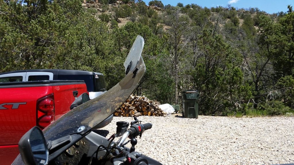

I found with the standard MG screen on my B11 that if I had it down and only just clearing the headlight I got buffeting but if I gave it 1/2" - 3/4" clearance I didn't
1993 TW125 "POS" - Resting
Re: General ??: Windshield design to reduce buffeting
« Reply #41 on: May 28, 2016, 05:40:23 PM »
Here's a side view of my SPIII fairing and the MRA X visor.  The MRA X smooths the departure from the screen and moves the flow up about 2" so it just clears my helmet.  Without it the airflow 'hit' my helmet just above the visor.  The visor is adjustable for angle and also has two arms so it can be placed further up or further away from the windscreen.
I do not have any pressure reducing holes and don't feel I need any.  I think the airflow from under the fairing through the forks and such compensates for the pressure difference.
 Charlie , doesn't the gap between the laminar lip and the main shield create a pressure
equalizer ?
Only near the lip.  That's the reason it works is it lets the air flow over lip of the stock windscreen without turbulence.  There is still a vacuum lower behind the shield.  I can feel some of it from the air pushing me from behind.  That part is countered by the flow up under the fairing to some extent.
PS If I was really interested, I'd either put some vents low on the windscreeen, or space the windscreen out away from the fairing by a bit less than an inch.

I have an old Shoei FM5 fairing -- it looks like a smaller version of the SP fairing. Just transferred it from the T to the Mille.  Solved the pressure differential problem by removing the rubber ring that seals the headlamp rim to the fairing. That leaves about a 5mm gap all around the headlamp to equalize pressure behind the fairing and windscreen. Oddly, rain has never come through that gap.

Sadly, my passenger gets more wind coming up from below.
I'm still play with the positioning.
