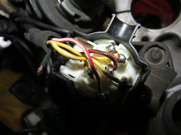

Apparently an open circuit at the switch where the wiring harness enters the housing. Looks like removing the switch is the next step. I'll be busy for a while. Any advice from y'all would be appreciated.
Randy
2007 Norge has been basicly trouble free for 87,000+ miles. But yesterday the bike wouldn't start. No parking lights, until I rotate the handle bar to the far left stop. Bike starts all is good until I move the steering to center position. Bike keeps running but headlights turn off. No re-start in the center position.  Apparently a wiring issue.............. .....Before pulling stuff apart, looking for possible ideas.  :angry:
Randy

« Reply #1 on: June 02, 2016, 01:27:28 PM »
Does the dash light up? If so clutch switch. If not? Ignition switch.
Re: Norge Weird random starting issue
« Reply #2 on: June 02, 2016, 03:52:37 PM »
If the wires are flexing where they go into the ignition switch chances are one of them is broken.
I'm not sure about the Norge but earlier Guzzis it was just a matter of unscrewing the switch block, 2 Phillips screws around the back to get the block off.
Re-solder the wire on and fix them to the housing so the movement is taken up by a gentle twisting over several inches away from the soldered joint. At a solder connection is the first place a wire will break.

« Reply #6 on: June 03, 2016, 10:32:30 AM »
Apparently the ignition switch has a broken internal wire, on to the next step....micro-surgery and with big hands a major challenge.......... ..... :sad:

« Reply #7 on: June 03, 2016, 10:35:43 AM »
The wiring is very close to the photo from Kiwi Roy, I'll photo the Norge failure for the site.
Randy
I added a short pig tail to the broken wire and re-installed the cover & zip tied the harness to complete the assembly. a test to confirm and I'M back on the road and heading to the Minnesota Rally later this month......

« Reply #8 on: June 03, 2016, 02:41:48 PM »
A big thanks to Kiwi_Roy :boozing:  Just putting details back together, all is good and should be back on the road tonight.

« Reply #9 on: June 03, 2016, 05:10:58 PM »
That's great, as I said before make sure the wires are fastened where they come out of the switch cover so there's no bending going on at the solder joint.
Just a gentle twisting over several inches. The first place a wire will break is at the soldered joint, the copper work hardens and gets brittle.

« Reply #11 on: June 05, 2016, 09:44:35 AM »
Randy
Randy
