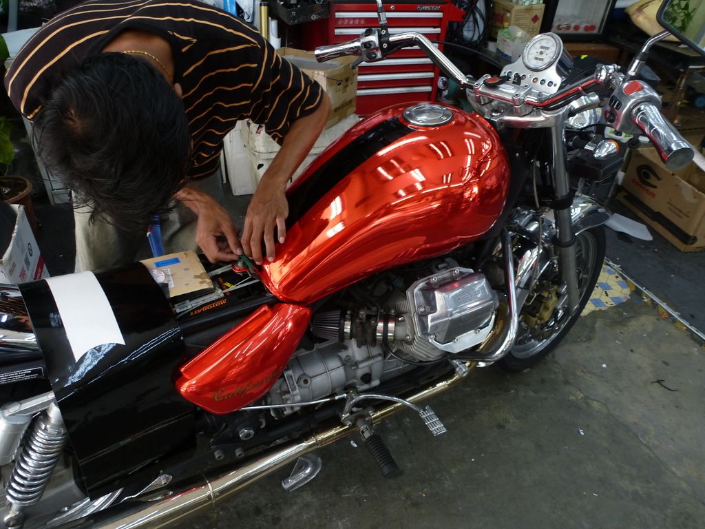

Here's my baby.
A 2001 California Jackal.
 I also have a Bellagio which I've converted into a cafe racer.
I put K&N pod filters on the Bellagio "Evoluzione" 940 Cafe Racer and was so happy with them that I put the same filters on my Jackal.
The induction roar on the Bellagio with the K&N's is awesome, but not so loud on the Jackal. It's more of a growl as you don't need to rev/change gears so often.
Anyways,........ My Jackal has always farted, burped and backfired, (even before the pod filters.)
Occasionally, it takes a lot of convincing to start and does a shotgun backfire through the exhausts. Really gets the neighbour's attention.
It has always/occasionally been reluctant to start, sometimes backfiring. Since fitting the K&Ns, it hasn't changed it's ways, though on two occasions the backfire when trying to start hs resulted in the injectors being blown out of the inlet manifolds when it has backfired through the filters.
It runs exactly the same as when it had the airbox, beautifully, even a bit smoother when cruising, but when it doesn't want to start straight away, hot or cold, it backfires through the pipes or filters.
Anyone else out there had their injector bodies blown off by a backfire?  I tell you, it's a real pain putting them back on, on the roadside using a small coin as a screwdriver on the manifold clamps. (I'm going to get in the habit of carrying screwdrivers from now on.)
I always assumed the reluctant starting was due to the Jackal's  Guzzi "Character" but the (only) other Jackal owner in Singapore says he has no trouble starting his bike. EVER.  :embarrassed: :rolleyes:
Occasionally, my Jackal will start up straight away, sometimes I have to hold the starter button for 20 - 30 seconds. Sometimes when it takes a long time to fire up it backfires like a shotgun through the exhaust, sometimes through the filters, sometimes the starter slows to a crawl and then refuses to turn the engine over, sometimes I hit the start button and all the dash lights go off and not a sound is heard from the relays OR the starter motor. My mechanic suggests it may be the starter motor, so I bought a new OEM Valeo starter which is in transit. Hopefully it reduces the number of starting problems.
Could the coils be a problem? I've replaced the fading rectifier and dead battery, but even so, when the starter turns quickly, sometimes the motor doesn't fire up and BANG !
any ideas?
Bob.
