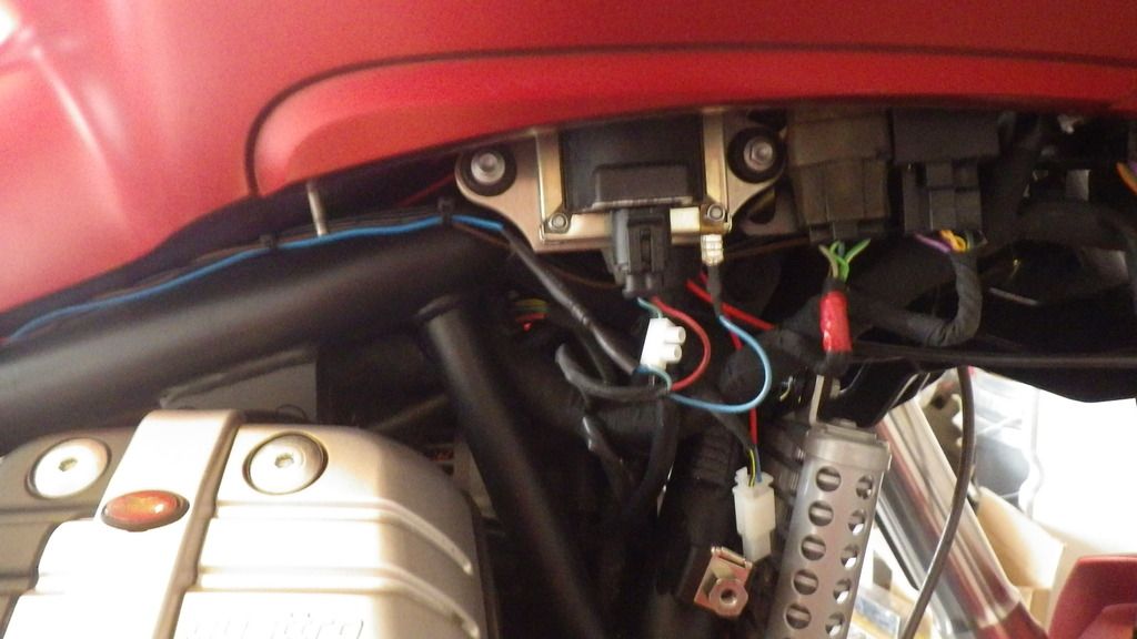

But I did get the job done and it works perfectly, so I will explain what I did and this should save you a lot of time.
I was able to do it without removing the fuel tank!  The previous message of mine explains how I got the engine speed to work for the green wire to the indicator.
The wheel speed (gear indicator white wire) was a little more difficult to deal with. But I have photos included here to make the job easier.
First step is to remove all your wires on the battery negative post and make sure the negative battery post cannot contact anything metal.
The best way to deal with the wheel speed wire (white) is to cut right into the harness at the ECM and find the gray wire with the white stripe. This is a direct shot between the plug of the ABS module and the ECM and there is no other simple way to get to this wire in my 2016 Stelvio. For this wire, you must work in front of the LEFT cylinder (note I already had my engine speed connection on the right side, but you  use the low side of the left ignition coil if you wish for the engine speed (orange/green on left side ignition coil).
The first photo below is for the engine speed (yellow wire to gear indicator, I used a resistor in series as mentioned in a Previous mentioned in this thread, which is under some heat shrink tubing).
The next photo is for the wheel speed. Notice my added yellow wire. That yellow wire goes from the gray wire  with the white stripe (the white  stripe is hard to see, so look very carefully with a magnifier in good light if necessary) that is inside the harness.   Very carefully cut the tape around the harness to find it. The red and blue wires are for other items I added and are NOT related to the gear indicator. That yellow wire goes to the white wire for the gear indicator. I would have used white instead of yellow for that, but I could not find any white wire so I used yellow. But it goes to the white wire of the gear indicator.
Behind the blue/red  and yellow wires,  mounted by the three Allen screws (as shown),  is the bike's ECM. You only have to dig into the front connector to find the wire. I dug into both sides trying to find that wire as I could not be sure which  connector of the ECU would contain the necessary gray wire with the white stripe.
It was very easy to calibrate when I got it working. I got that job done in a half block of riding by just letting the engine lug in 4th, 5th & 6th gear and then I only tested it and it works perfectly.
See photos below:
Engine speed (green gear indicator wire) connection (Blue wire that goes up the frame from the European connector I added to the low side of the right side ignition coil):
Wheel speed connection (white gear indicator wire to my own yellow wire at harness):
In above, disregard the red and blue wires I added. Those wires are for other things unrelated to the gear indicator. It's the yellow wire that goes between the gray wire with the white stripe inside the harness to the white wire of the gear indicator (for the wheel speed info.).

It's really not that difficult, the idea is to remove enough  (a couple of inches) of the stock black tape (must be cut into, unfortunately, as there seems to be no way to just unwrap it)   to expose all the wires in the harness, without harming any of the wires.
The front of the ECM connector uses something similar to electrical tape, but on the rear ECM connector it uses a cloth type tape, perhaps because of the more heat in the rear. But there is no need to touch the rear cable. Of the two connectors, the front is the easiest to deal with, so there is some good news. But the main idea is to get a couple of inches of the tape removed from  that front ECM connector without harming any of the wires inside.
Then find the gray wire with the white stripe and tap into it and connect it to the white wire of the Gipro gear indicator by any method you prefer. I cut the gray wire with the white stripe and stripped off about a half inch of the insulation of each and then added my yellow wire and soldered all three connections together. I used heat shrink tubing to cover these connections and then taped up the whole thing using tie wraps to help hold the tape on (for when it all ages). But you could simply use a small Posi-tap or something like that, without even cutting the gray wire with the white stripe. But then,  covering it all up could be a problem, that why I decided to just solder it all.
Then deal with the other wires for the Gipro, which are easier to deal with.
Cutting into the ECM harness is not that difficult, but you have to be very careful not to cut any wires in so doing.

« Reply #22 on: February 04, 2021, 07:14:41 AM »
I realy solved it by reading all of your comments
 i have a 4 wire(battery +, ground, rpm and speedo) 6 speed gear indicator from ali...30 euro.
I detached the 26 pin (tyco) super seal connector from the dash and used pin 17 and 18 for the rpm/speedsignal.
No cutting in to the harnes or wires.
Unclip the retaining tabs, pull out pin 17&18 and solder a thin (like telephone wire) wire on each of the and you can put them back in the connector.
The soldered wires stick out from under the rubber manchet/cover, hooked them op. Then you start your bike an as soon as the indicator get a(aboveidle) rpm signal it goes into L Learnigmode and passes trough the numbers 1-6...just shift accordingly (had my rear wheel from the ground) and it counts and memorizes the rpm/speedsignal ratio for every gear.
2 minor remarks...in daylight the indicator has no curb appeal and it only functons with rotating wheels and rpms above idle (for mine its 2100 rpm
