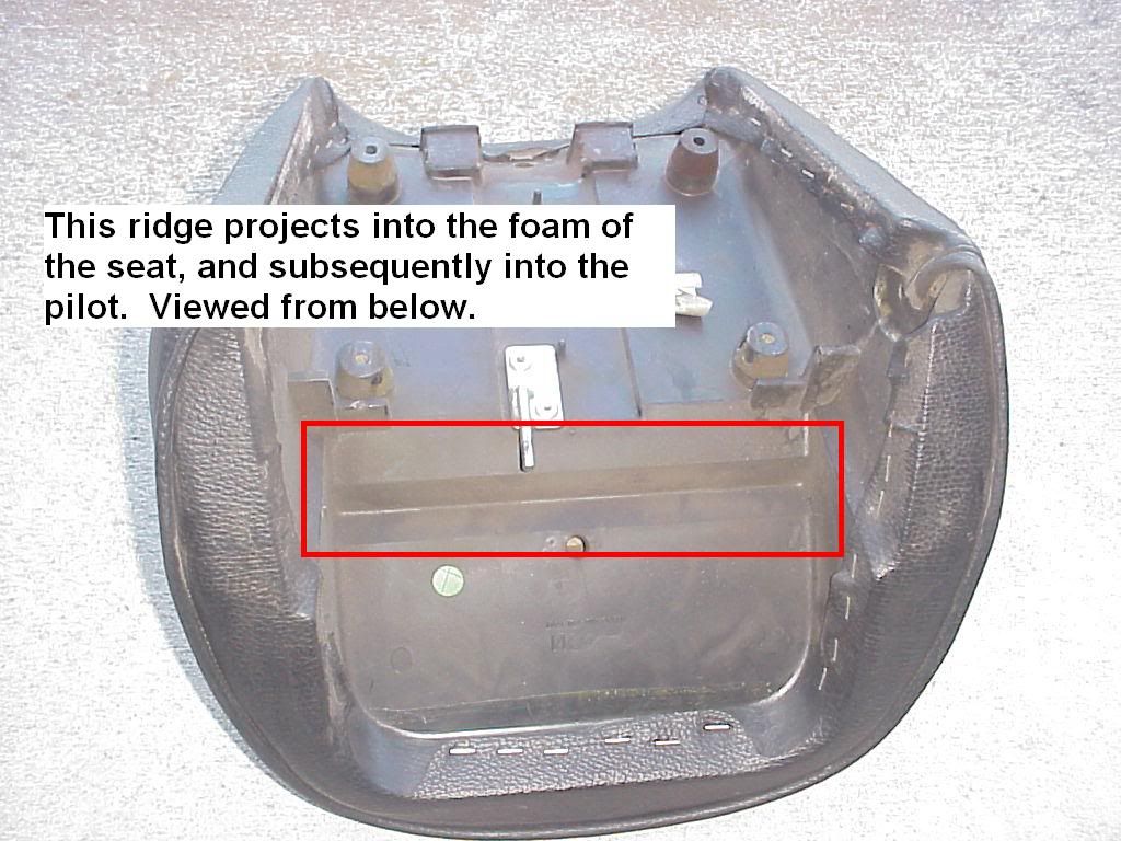

pehayes: Thanks! I'll post a pic of the underside. Does this look like a stock pan? (See pic) I don't see how this could get as narrow as the pictures I've seen of the stock seat (like Bikes posted)

Bikes: That's a great idea! But...first...I talked to the local upholstery guy today and he's going to charge me 60 bucks to trim it down some. As he said, he can always put what he cuts out back in if it doesn't work. I'm going to see what happens. Thanks for the idea and offer. We'll see.
What do you think. Does this look narrow enough in front to be stock?
Yes, that is a stock pan.  I see that someone  has already cut away the nasty 90 degree relief  area required by the earlier P8 computer.  That is what you see where all the pop rivets are located.   So, you could use lower, denser foam to get the seat surface down to your liking.  Here is what the plastic pan would have looked like before being cut away.

pehayes: thank you for the confirmation and picture. It's great knowing exactly what I'm dealing with.
