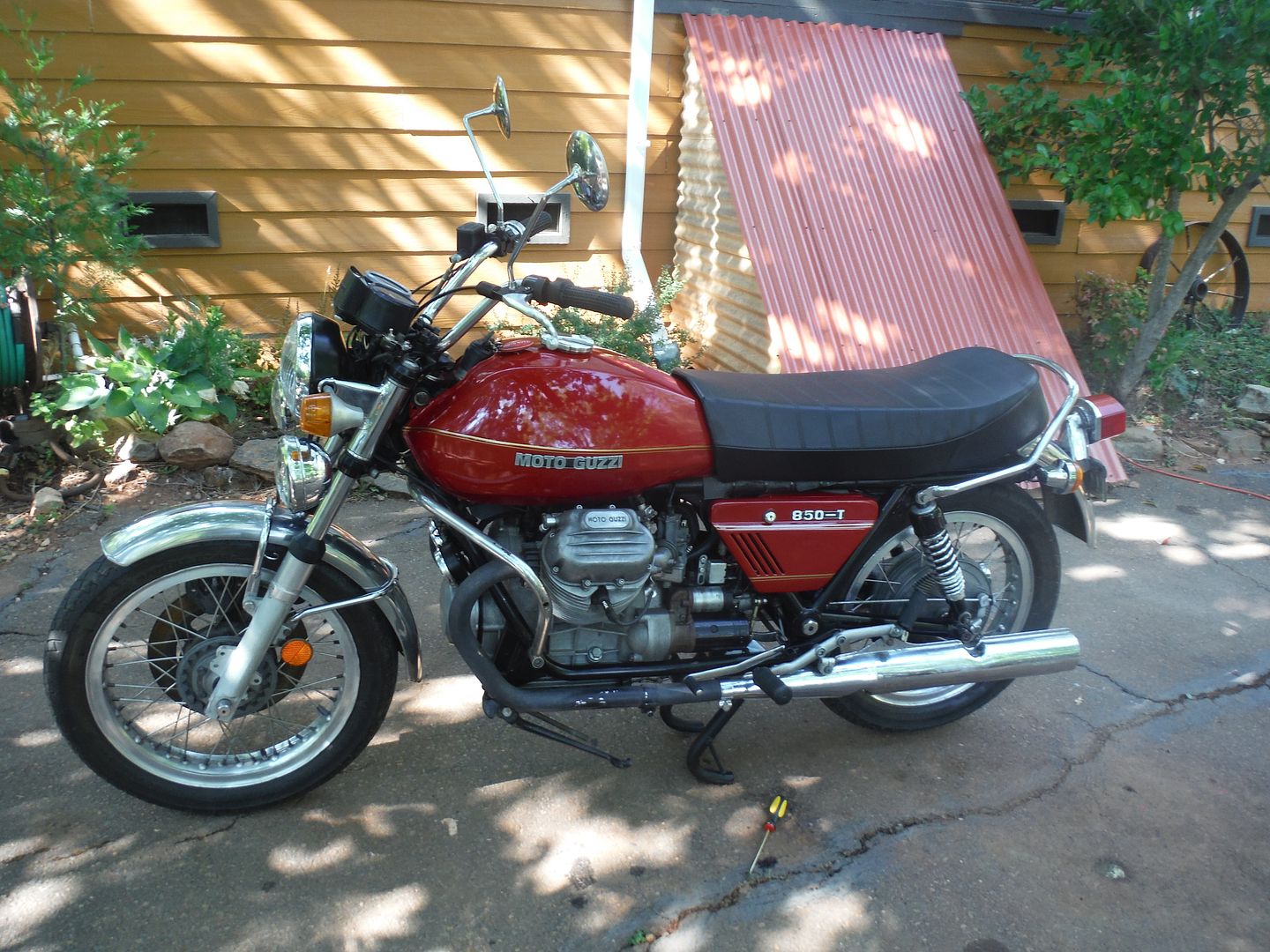

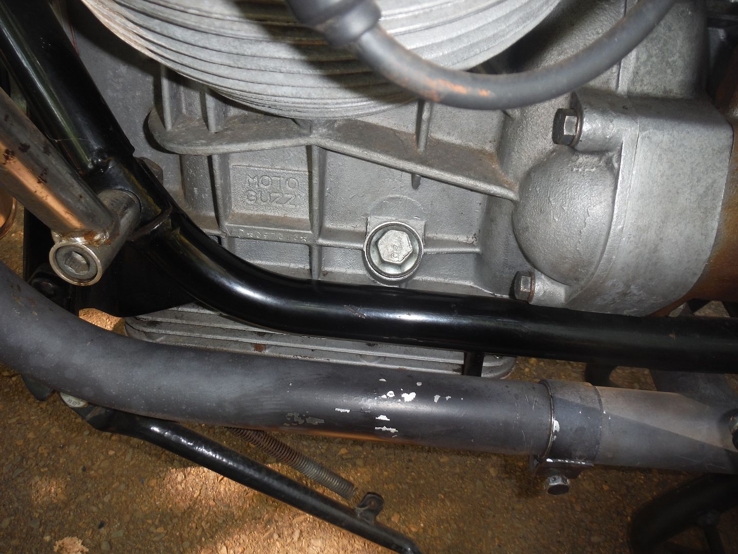

Ok I will do that to be certain right amount - I attach photo of oil fill nut and one of the back of it - no indication that anything was ever attached to it.  Also one of my old girl - gave her a clean today and a new battery.

That's not an original Guzzi oil fill plug/dipstick - looks like some generic plug from the auto parts or something from another vehicle. PM me your address and I'll get a good, used, original dipstick off to you tomorrow.

Front fender blade in backwards? Something looks off.
Nice bike overall though.
Good eye. Overhang on the front shorter. Maybe it's the camera angle. Maybe not.

« Reply #9 on: August 27, 2016, 10:04:46 AM »
wow!   I never spotted that!   Let me look at some original pictures and see if that is indeed the case - I am pretty sure I never took that off so PO probably put it on like that!
Lee

« Reply #10 on: August 27, 2016, 10:11:17 AM »
Hmmm  - have looked online at a number of pics and all show the front fender shorter at the front with the curved support bar to the rear....

« Reply #11 on: August 27, 2016, 10:20:50 AM »
Good looking bike...like the red tank vs black headers, very sweet...yeah, check that front fender mounting...Guzziolo gy has a lot to say, maybe look for an old version to cover your bike

« Reply #12 on: August 27, 2016, 11:24:36 AM »
The support bars are located and oriented correctly, but the fender should be flipped 180 degrees.  Lovely bike.

« Reply #13 on: August 27, 2016, 11:52:41 AM »
Time to repaint the headers - i used a generic high temp spray paint and its held up pretty well for the past 5 years or so - I will work on the fender tomorrow - nothing like the Guzzi aficionados to spot something like this!!!!   :)
New headers are about $200. They would make that bike perfect. That and flipping the fender (free).
