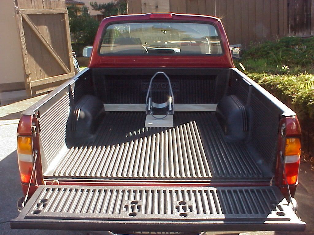

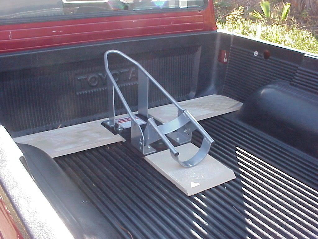

I have the cheepo Harbor Freight over-center wheel chock.  I mounted that to a set of boards that fit snugly between the wheel wells and the front wall of the bed of the pickup.  The device just drops in and out easily and the chock is a big help in stabilizing the tie down process.  Nothing permanent involved.

Like Patrick sez.  Still only $39.  I have two of them in toy hauler.
http://www.harborfreight.com/motorcycle-wheel-chock-69026.html

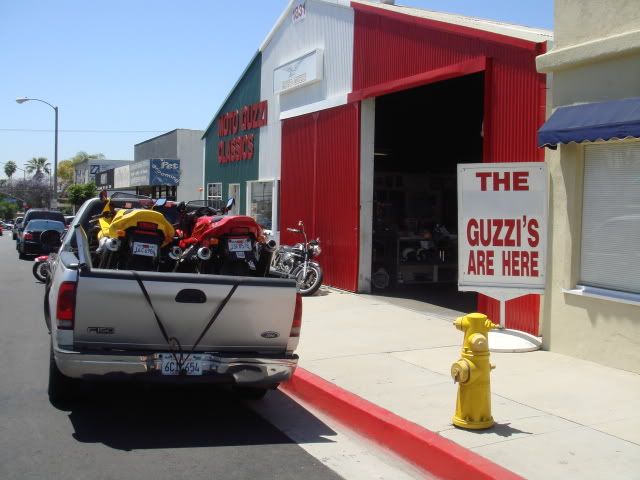

'97 Daytona RS and '97 1100 Sporti on the wayfrom Torrance/Signal Hill to San Diego to be shipped out to Hilo, Hawaii.  No chocks.  Strapped down.  4 straps each always.  Short bed, extend cab truck.  Ramp to load at Ed Milich's house and Mark's MG Classics to loading dock at Pasha's warehouse.
