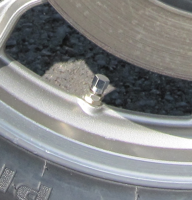

I have those same rims on my 81 G5. I ended up converting them to tubeless; So far so good. 2 years later, all is well.
You have two choices for valves that I'm aware of that are a direct fit to those rims without modifications:
- Parts Unlimited Part# VS-1218R - https://www.denniskirk.com/parts-unlimited/all-metal-valve-stem-vs-1218r.p54155.prd/54155.sku
- Napa Part# NTH 90426 - https://www.napaonline.com/p/NTH90426
I ended up using the Parts Unlimited VS-1218R, but with one rubber only as the Napa part is shown. I test fitted both, but I preferred the quality of the Parts Unlimited one so I went with that one, but really both will work.
Notes:
1) I had to shorten the metal valve caps about 1/16" otherwise they would not tighten down to the seal when using the two locking nuts. You could use one nut like the NAPA one shows, but that didn't put my mind at ease enough, so I went with the two in locking setup.
2) I didn't do this on this first installation, but now that I am convinced this is the way to go with those rims (no leaking and such), I will I think next time drill/machine a flat spot where the rubber sits for a better seal. The way it sits now, the rubber has to form to the concave shape of the inside of the rim (that's the whole point of the rubber, but it's close and the seal could be better by making it flat). I did use a touch of NAPA Bead Seal between the valve rubber and the rim ( https://www.napaonline.com/napa/en/p/BK_7101204/BK_7101204 )
3) Not all tire places will install a tubeless tire without a tube on a tube-type rim, so you'll have to find someone whom will do that for you. It has to do with liability I think - Anyway, I researched those particular rims a lot along with rim types and profiles of TT vs TL rims - My conclusion was that not only will those rims work for tubeless setup, but IMO tires are actually less likely to come off the rim because of the seating profile they have. The rims you and I have, have a WM marking and CP (Conrtre Pente) which indicates a reverse 4 degree angle) that actually locks the tire on the rim in the event of total air loss better than a true tubeless rim which does not have the reverse angle. Anyway, that's my conclusion and works for me, but do at your own risk and research it until you are comfortable with doing the conversion < that's my disclaimer.
Rim markings on mine (81 G5)
Tubeless Conversion Valve, Parts Unlimited VS-1218R on same bike (after restoration):
Hope that helps, and good luck.
Notes:
Groover,
  Thanks for posting this. All very helpful. I have owned this bike for about 5 years, and each tire change, considered to the swap to tubeless. I asked a couple of local shops if this would be feasible, but they did not want to do this. Liability, as has been mentioned. I am looking for a smaller, maybe a one man operation that may do this.

 Btw, the bike that we are talking about is a 83 Le Mans with the cast, hour glass wheels.
I dont know why I thought you had a bike with wire spoke wheels...DUH!
With your LM III wheels its a piece of cake to go tubeless, and a no brainer IMHO. You got some great technical information here though.
