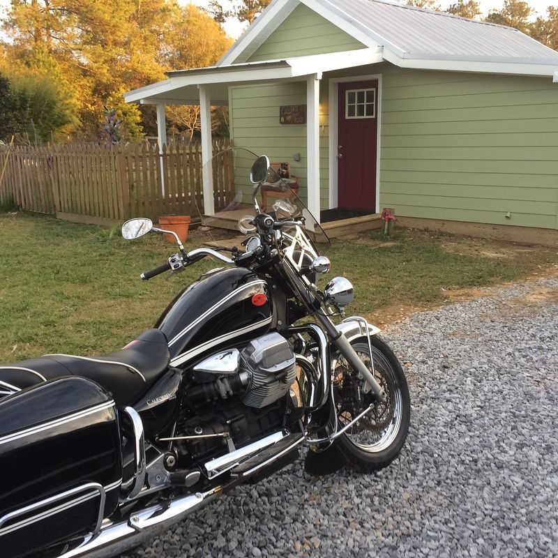

#2, no problem and thankyou, beautiful bike BTW. #1 for me is an issue as you explain it, because a migration of slime to the area furtest from centre will only increase the mass at that point. Do you perceive a problem there? That would be a problem on an eccentric wheel wheter or not it was mass balanced, I honestly do not get it and I don't know why.
