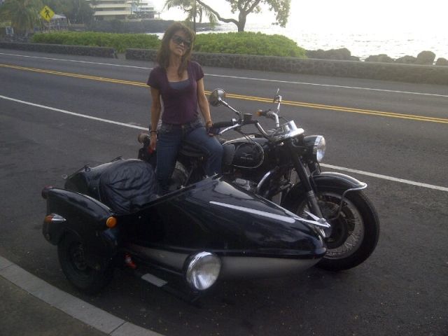

Dean,
We use the Velorex 565, on the '99 EV, the car is a 2005 model with a updated wheel spindle, it fits well, once set up correctly they are a blast.
You will want to carry a few pounds of counterbalance weight when you don't have Cindy with you.  Well, unless you like lifting the car, I personally do not.  On hard right handers, the car will come up easily without weight in it.
The top of the Velo lifts up for easy access for the passenger, this one has a fully enclosed top as well.
I did install a Unit Forks Leading Link front end although there are other methods to ease the steering effort such as EZ-Steer triple tree replacements.
The Unit also slides into the existing Guzzi trees.  One day I would like to graft the EV front fender back onto the Unit Fork, I think it looks better plus it is a full coverage fender.
This is how ours looked when we got it years ago...
Anyway, properly set up, they are fun.  I use this one quite a bit actually.
Since then I have converted to the Unit LL Forks and swapped the big-ass screen with an Aerofoil...

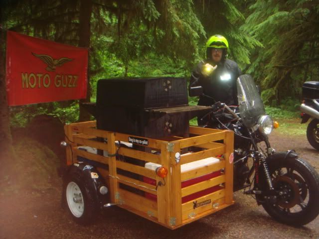

Dave Talley with his equipment hack.  He showed up with a gas bbq for the Deep Forest Campout in WA.  He made some teriyaki pork.
Offline radguzzi
  • Posts: 7351
Re: Sidecar for my EV?
« Reply #14 on: October 17, 2016, 06:36:07 PM »
Wow Tom,
Dave wins...  well, in that category, the Boss wins in the other...  :wink:
