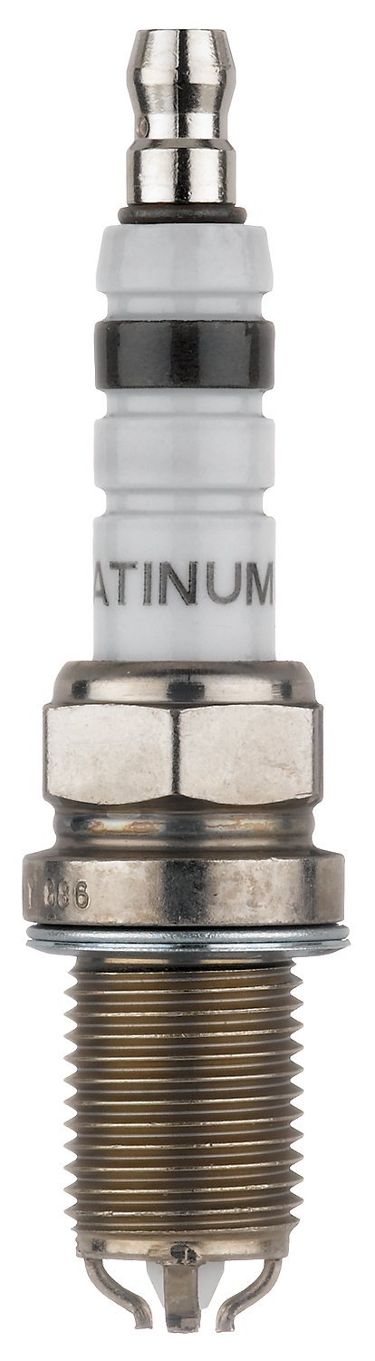

I wonder if those spark plugs are worth to be concidered and if not what you would recommend:
https://www.amazon.ca/PERFORMANCE-SPARK-California-Vintage-R9QT2431AR12ZSYU4R2431/dp/B00DAXOXPW
Thanks!

I for one would be suspect of any plug that claims to improve spark voltage.  The plug has no control over that spec at all.
I have had great luck with the Bosch Platinum+4 on my Norge.

I would use a platinum or iridium plug before I sprung for what the performance plug costs. I have Denso Iridium plugs in my Stelvio and they work great.

NGK (7131) BPR6ES   -Outer   qty 2
Autolite 4303 Copper Resistor Spark Plug  -Inner   qty 2
NGK 8051 Spark Plug Cover  qty 4
All the plugs have the top that screws off so that I can use the NGK plug covers that clip securely to the screw top of the plug.
Plugs available at most autoparts stores for about $2 each and the NGK 8051 were $2 each at amazon.
Cut the old plug caps off carefully without shortening the wires and reuse the wires.  They are copper wire  and good quality.
