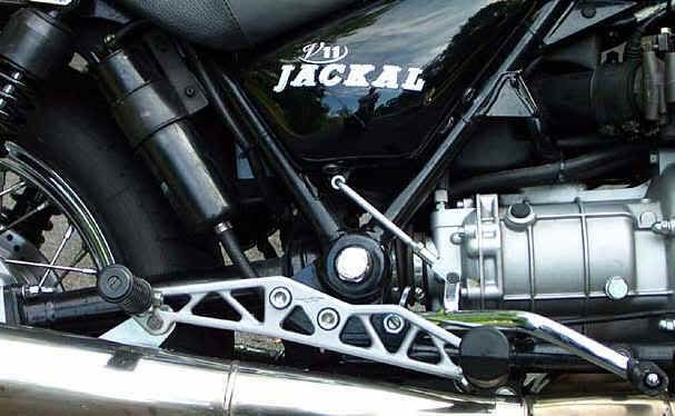

Couple choices, both actual Guzzi parts. 1) Tonti Lemans  ( your choice of series).  2) T3 type ( maybe even cheaper to purchase used) and modify accordingly . Both will require brake pedals, but using those from LM's or T3 could work as well.

You could use plate steel for mounts.  Cut to order.  Paint.  The later model bikes use lattice type mounts made out of aluminum.
These are T-5, SP II mounts on a '00 Jackal note the Guzzi Eagle cast into the aluminum.  Spiffy!:
If you use LeMans parts it will move the foot position back.  Here is the semi-complete bike:

I posted some pic on F.B. wildguzzi group page.  I used the oem rear foot peg bracket to start my rearset setup.  Front pegs are where the rear are and the rear are mounted where the exhaust was hung.  I modeled the shifter after the sport1100,  There are oem sport shifters that are available if you do not want to fabricate as I did. It will mount right up to the Tonti frame.  Made a brake lever and master cylinder set up that worked with the pegs.  I posted a right and left side view.
The spine frame bike has many of the dimensions/geometry as the Tonti frame. When I started my project, I found drawings of the various Tonti frames and Sport frames to help decide on oem parts.  Saving time in fabrication plus keeping the bike o.e.m.  My build has parts from 14 different models.
I couldn't see a F.B group for wildguzzi... got a link?
I thought about using the oem foot pegs - when riding i joked to myself it was comfier to use the rear pegs than the boards, but thought they were a bit too bulky - and turns out a little too far rearward...
Thankfully the footpegs I managed to find came with the brake lever and the gear shifter so hopefully all the big purchases are done... well, maybe some new rear shocks.... we'll see... good to know the spine frame guzzis share parts... I was limiting my ebay searching to tonti bits and bobs...
