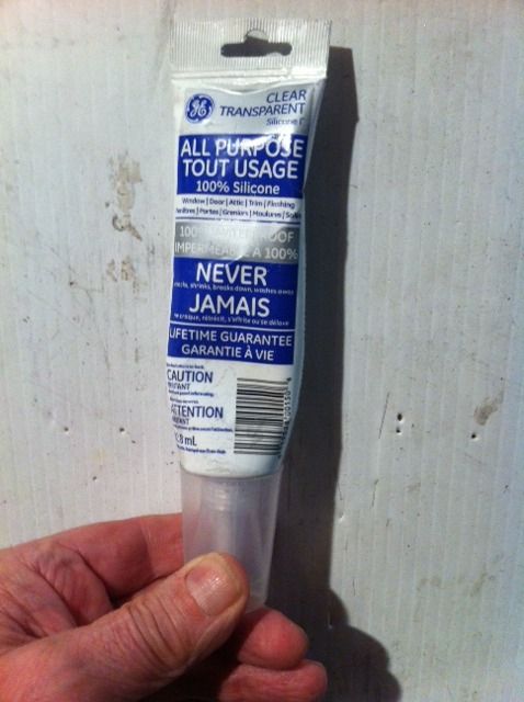

you didn't say how you accomplished getting the wheel tubeless. Did you have them welded or by some other means of sealing the spoke holes in the inside?
A $3 tube of Silicone, in the process I learned not all Silicone is created equal, the first variety shown in the slideshow wouldn't stick to the Alloy rims but the one I have now sticks like sh-- to an Army blanket.
At first after wire brushing the rims I used circles of duct tape over each nipple with a layer of Silicone over the top followed by more duct tape, that was a waste of time.
Now I just use silicone, if I ever have to tighten the spokes I will just re-do the whole process, it only takes about half hour per rim.
My local bike shop was a bit dubious but I buy all my tires there so they decided to humor me, since then I just use a couple of tire levers, I didn't realize how easy it is.
http://s1304.photobucket.com/user/Kiwi_Roy/slideshow/72%20Eldo/Sealing%20Wheels?sort=2
I have since switched to GE Silicone I, 100% which comes in a small tube at the hardware store
This small tube is enough to do 2 rims.
The California II of course has cast wheels so they are easy.
You do need tubeless valve stems or tank valves in the case of cast rims.
