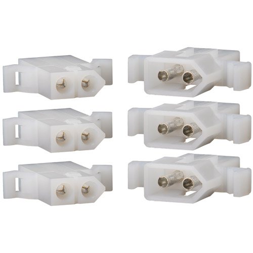

Offline ITSec
  • Posts: 3040
  • Location: Southwestern US
Re: Fine Guage Wire Connectors
« Reply #9 on: December 31, 2016, 09:28:50 PM »
Hmm . . . I know I need something detachable . But without experience,  don't know what to choose. The bike has all kinds of nifty detachable plugs and connectors from the factory. All engineered and sh*t. Maybe I'm overthinking and should just get the smallest bullet connectors I can find.
For this type of connection, I use Molex connectors (similar to those used in computer work and some automotive) and put heat-shrink over the back of them. You would need a Molex crimper (usually about $25) and some of the appropriate connectors. Molex connectors use male or female pins that you crimp on the stripped wire and then push into place in the connector. This helps eliminate strain at the wire crimp, since the connector takes most of it.
You can get them in 2,3,4,5,6 or more pin connector types; I use the 4-connector type for my extra rear lights (+ for turn, brake and running and -, 4 wires on each side).
