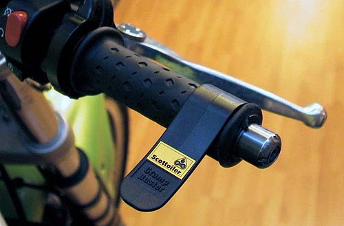

Thanks for all the info.  I was looking for a throttle lock, rather than a true electronic cruise control.  I've played around with the Cramp Buster, which helps, but is too much of pain to put on/off.  Your alternatives are good.
Here's a stock image;
