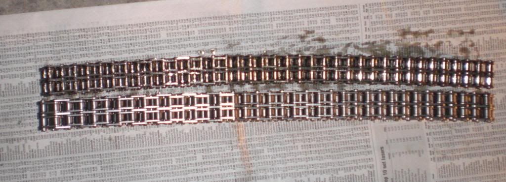

  • Posts: 10224
Re: 97 1100 Sporti Timing Chain Tensioner
« Reply #20 on: March 26, 2017, 10:43:57 PM »
A couple of owners mentioned that you need an extra deep 32mm socket, I tried in vain to find one.
Just buy a regular 32mm 3/4" drive. it easily passes over the shaft.
Protect the shaft with a couple of layers of masking tape then turn the socket with a pipe wrench or grind a couple of flats for a 12 inch wrench.
Of course if you have access to a welder just cut a half inch drive socket and extend it with a length of pipe.
For some reason the bolts were too long without the old tensioner bracket so I cut it off and scratched a note for the next owner.
At 80,000 km the old chain showed little sign of wear, Im sure it would be safe to run to 250,000
« Last Edit: March 26, 2017, 11:12:23 PM by Kiwi_Roy »
