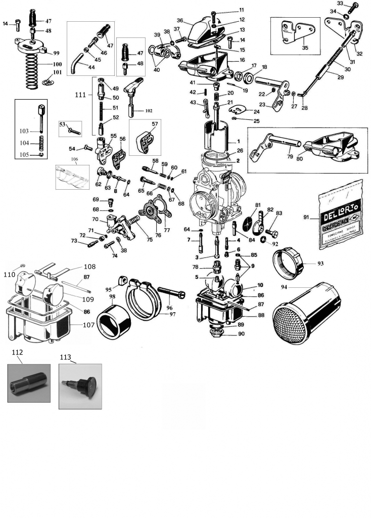

New choke cables arrived, something is not right, the cable is too long to be of any use
the choke cable end at the carb 90 degree pipe end
There is no cable adjuster on the 90m degree pipe end
Something is not adding up, maybe the wrong cables were sent??
What an I missing here?
You're missing the adjuster and locknut.

Re: 1977 Le Mans Rebuild almost done
« Reply #325 on: December 04, 2017, 11:21:09 PM »
Does the adjuster and lock nut fit between the 90 degree pipe fitting and the cast aluminum cap that bolts down onto the carb?
The carbs came without adjusters so I am not sure where they go, but can't think of where else they would fit.
« Reply #326 on: December 05, 2017, 02:37:02 AM »
The parts diagram show the adjuster, lock nut then elbow covered by a rubber sleeve.
« Reply #327 on: December 05, 2017, 08:49:12 AM »
Thanks
Jim
It screws into the upper end of the elbow. Check out the box with nos. 44-47 in the illustration below:

« Reply #328 on: December 05, 2017, 09:19:28 AM »
Thanks again Charlie!  I doubt I have any of those in my  stock, one more parts order for the LeMans coming up.
