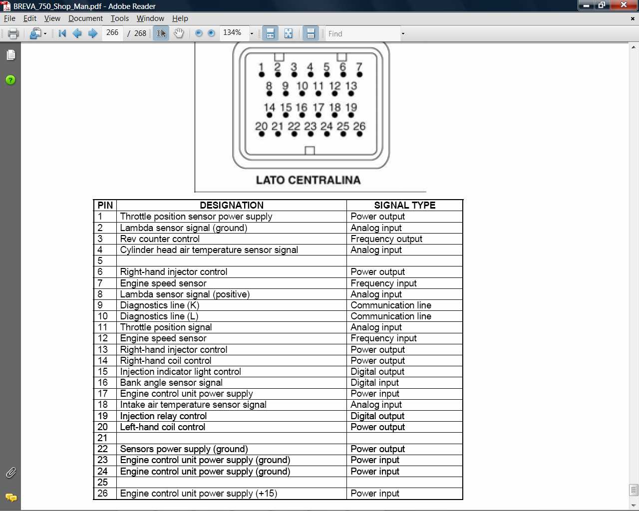

BTW, I have a ZIP file (a bit large, 37 MB) with all the manuals and a bunch of other useful info for the 750 Breva. If you want it, send me a PM with your direct email address and I can forward it to you.
The wiring diagram above is accurate, but there's a bit better explanation and discussion in some earlier threads, such as:

ECU = Engine Control Unit
Its primary function is to control spark and fuel injector timing, based on real-time integration of sensor inputs for ground speed, engine RPM, throttle opening, altitude, and air temperature .
A "Reflash" re-writes a different version of the "Fuel Map" stored in an EEPROM in the ECU, which is basically a lookup-table that determines the best crankshaft angles for spark fire and injector pulse for each cylinder. The ECU is an amazing bit of electronic wizardry:
Here is a link to a reference text file that I maintain to help me with maintenence of my own 50,000+ mile 2004 Breva 750:
  http://www.dansher.com/bikepix/Guzzi/_V7_fyi.txt
'Geezer
MOTOgeezer
WOW
I almost missed the significance of your post  :bow:
Take a close look at what he's put together guys
« Last Edit: November 01, 2017, 10:53:58 PM by Kiwi_Roy »
