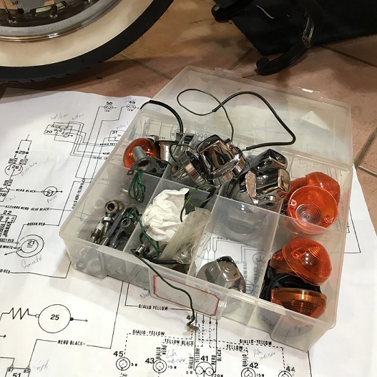

The tail light is nearly the last of the electrical.
The Greg Bender wiring loom was a good investment, easy to fit (for a elec dummy) and super high quality.
Two 100 psi pressure gauges and three braided lines arrived from Marlin/USA and Speedway motors but after to many dead end local phone calls I could not find a off the shelf M12 - 1.5 pitch banjo bolt with a 1/8" NTP thread in the head (Plenty in the USA based on google) so will have to make one so I can retain the oil pressure sensor and have a take off for the gauge.
One original push/pull dash switch was seized and had to admit defeat.
I got two new switches in the GB loom kit but being modern they had plastic rings and ugly knobs plus the thread was a different pitch to the original rings.
No problem, course M8 pitch (.1) goes in fine pitch (.75).
New switches with the original knobs and knurled alloy rings re tapped for the best of both worlds and no plastic bits in view.
The original Lucas L874 front indicators were in place but nothing on the rear ( Orange lights on the Dan Brown panniers)
Having British bikes and spares I made up a set for the rear as the chromed bracket that held the originals came with the bike.
