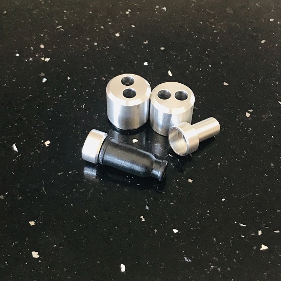

I could stick something (a drill ? ) under the slide to get them close to synchronised or for 5 minutes time @ 28.95 mm OD and  5.2 mm high.  :laugh:
My hope is it will start instantly with a sniff of petrol and spark.
LesP
Re: Eldorado and the quest to ride a Moto Guzzi for the first time.
« Reply #319 on: March 22, 2020, 07:34:23 PM »
Egads.
6.8 mm OD by 6.8 mm deep with a 6 mm bore.
I need to put (machine) something under those original carburettor cap bolts (Never had anything)

« Reply #321 on: March 22, 2020, 11:35:26 PM »
One tube insert in the throttle so no more flop there either.
This one is a sliding fit and should stay put.
The first one was a firm push fit and with no slit for the inner cable would have been interesting if the cable needed replacement so it was make another.
The overall throttle action is Super (Pratic) so worth the screwing around (9 machined pieces overall, choke and throttle)
The bike had separate choke plunger kits when I got it but got a stock unit off eBay but as it turned out a pin was missing to stop it rotating.
I could have machined something not worth machining like tapping the body M4 thread and machining a M4 fastener to have a 3 mm step down shank to fit the 3 mm hole in the brake perch.
Instead I went full on bogan, carefully battery drilled the perch with an old 1/8" drill (3.175 mm) did the same on the choke body hole and then cut and ground the drill to make a pin.
Loctite 660 should keep it snug in the choke body.
