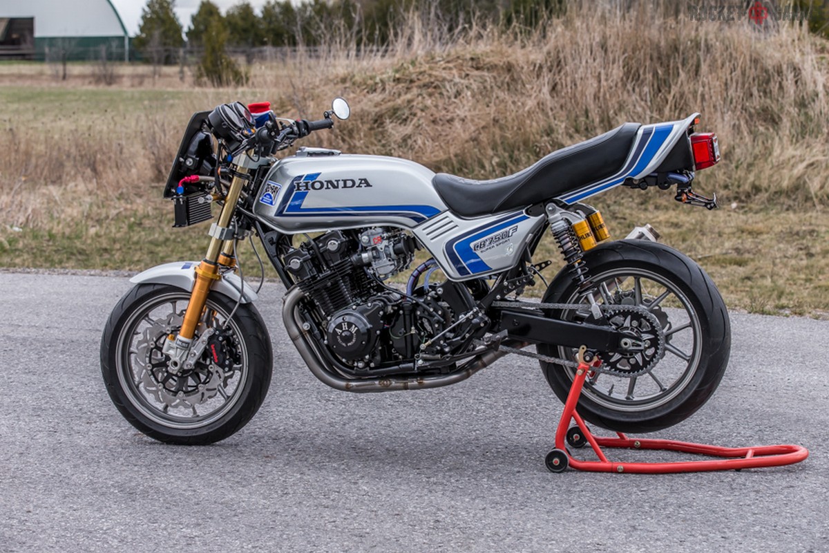

I like where you were going, but that seat is not sitting well  :grin:
Looks like it needs something behind it, a cafe cowl or ?? Otherwise, nice job.
2007 Ducati Monster S4Rs
Rough Edge racing
Re: The unloved 81 Honda 750 build
« Reply #31 on: February 14, 2018, 11:30:34 AM »
 I'm trying to avoid the common cafe theme with the cowl and no rear fender...And the cost, there are very no options other than a $300 plus custom made seat...The Harley Sportster seat is a bit  more cruiser style than I like, but it was inexpensive ,to fits and is comfortable...

« Reply #34 on: May 07, 2018, 07:55:16 AM »
 I've been riding the bike and it's all ok...I spent some time messing with tuning because the CV carbs with pod filters and a 4 into 1 aftermarket exhaust can be problems. A Dynojet kit ,new intake rubbers and clamps, time spent adjusting carbs with a manometer and it runs nicely from idle to redline...Good throttle response at lower speeds with the expected rush of power from 6500 to 9500 rpm...The handling with the 96 750 Interceptor front end parts, 26 degrees fork rake, 4.2 inches of trail and 89 Interceptor rear wheel is reasonable . The bike now weighs about 510 pounds with fuel..But my tuned 96 Ducati 900 M is faster and for sure handles and feels better, the Honda being more numb that I thought it would be..Maybe the Avon Road Rider bias tires are part of it..
   The total price was around 2200 bucks including the purchase of the beat up 750C...I enjoy riding it on the rural back roads..
