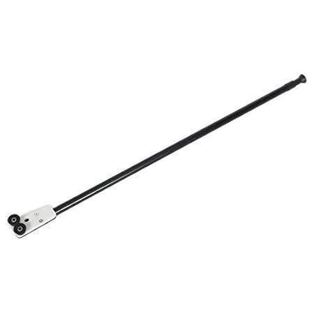

I use a Sealy TC963 bar;
http://www.sealey.co.uk/PLPageBuilder.asp?id=20&method=mViewProduct&productid=8460
Works well although due to the bulk of the rollers it can be a little tricky to get it into the skinny tyres on my LM2, not sure if the Mojolever might be a bit more slimline?

If you could find one used, maybe a mount/demount bar from a Coats 200/220 would work better?
With plastic rim protectors in place.

Charlie Thanks for the images of the Coates bar, looks like a much finer profile that will create less stretch of the tire, will spend some time in the workshop today and turn up something similar an give it a try. Its so much easier to look at a proven idea and copy it than to stand in front of the mill all day creating a mound of swarf on multiple ideas that may not work Thanks Bill
