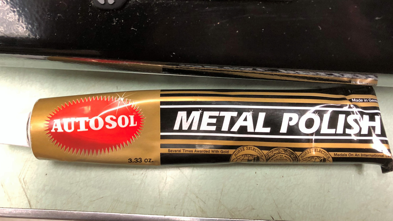

I pulled the rear wheel off to give it a thorough inspection and clean up before mounting the new rubber.
The aluminum Akront rims were in good shape, but cruddy.
After a couple of hours rubbing out the rims with Autosol, and going over the stainless spokes with 0000 steel wool yielded a good result.
A new Akront sticker to replace the old.  Also a pleasant surprise - the rear wheel was still very true.

The uber rare front fender is in perfect condition.  It polished up nicely.
Re: 1000S Restoration
« Reply #22 on: October 28, 2018, 10:18:40 AM »
Looking real good Dave,  do you use a polishing wheel and compound to get the stainless steel fender to shine up so nice?
If so what colour of polishing stick do you use?
I have tried red and white and can't get my stainless steel parts to shine up as nice.
Thanks
Jim
  • Posts: 4852
« Reply #23 on: October 28, 2018, 10:52:37 AM »
Jim, I was able to polish the fender by hand with Autosol.  It wasn't much of a challenge as it was in great condition.   If it needed a session with a polishing wheel I wouldn't trust my own skills with such a rare piece.  I would send it out to Elite Polishing.  Steve Langston is a wizard at the polishing wheel!
« Reply #24 on: October 28, 2018, 10:56:51 AM »
Thanks Dave
I will try the Autosol on the Benelli rear fender and see if I can get it to shine up, it's quite dull and against the new chrome is shows its age. Kinda how these thing go isn't it, you get one part to look great and then it forces the quality of the rest of the build up a notch.
