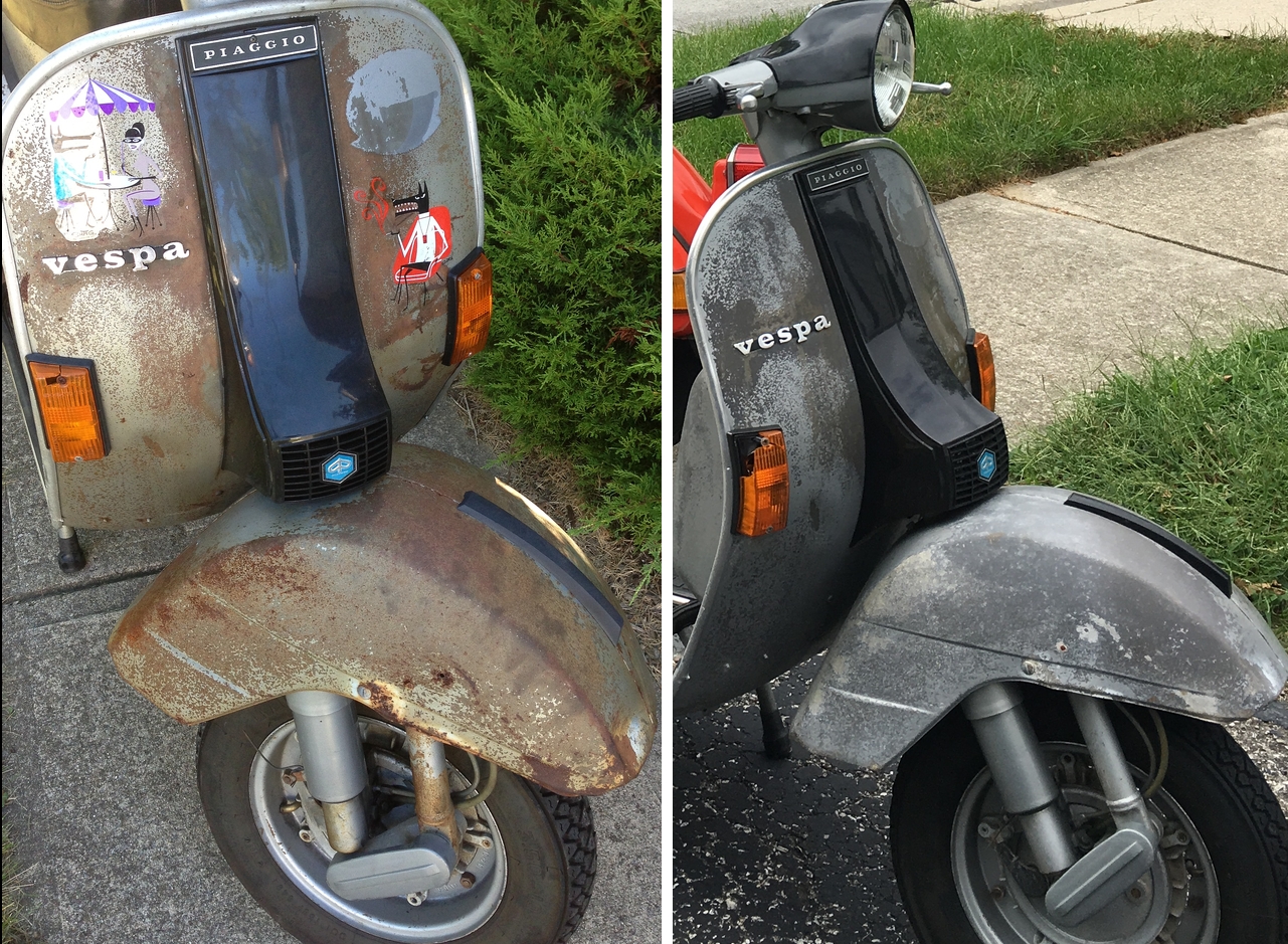

Very cool project. I did something similar a few years ago with one of my vintage Vespas. I used Eastwood's Fast Etch (https://www.eastwood.com/rust-remover-eastwood-fast-etch.html), which converts rust into zinc phosphate. Not sure if it's what you want, but these are my results. Best if applied on a warm day in the shade (not direct sunlight) let it do convert, then wash and wax. It kept the patina, though not as "rusty" looking which is exactly what I was aiming for. It has maintained that new appearance years later, the only places where rust has appears again is if it was under some lifted paint where the product didn't get to it previously - if that happen, then either leave it or spray it again - I've only sprayed mine once in 2013, the "after" photo I'm using here was taken in 2017. Also, I did not repaint the forks - the fast etch just made the rust there look grey which almost matches the factory silver paint (from a distance).
Word of caution, it does mess up some plastics - for example it's old dried up black plastic, it will streak it white - long story short, this works but use with caution and once applied, you can't get rust back there if you wanted it...
Hope that helps.
