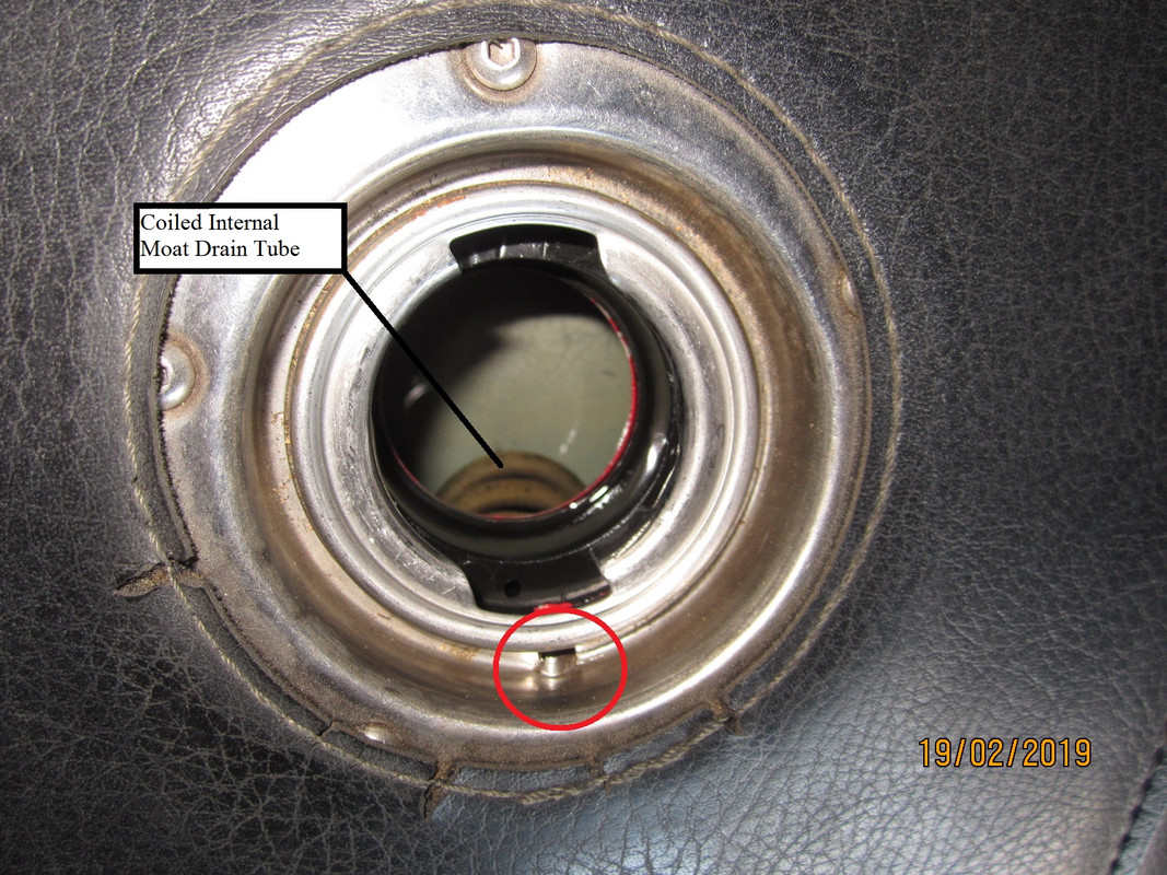

and wile im here, I read about the moat drain...   I cant see the hole from the top, so how do I pour something in it to see if its free?  I was planning on running a guitar string up from the bottom...

The Moat Drain on my 98EV is a little dimple in the 6 o'clock position of the fuel filler.  (Sorry, my tank has a vinyl cover.)  The drain is a coiled tube down through the tank to exit through the bottom/center of the tunnel.  The coil is necessary to allow for expansion/contraction of the tank body.

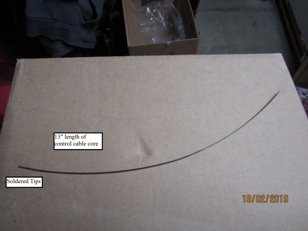

The tool I use from below is a 13" section of control cable core with soldered tips driven by a slow electric drill.  The solder keeps the cable filaments from fraying.  A longer length just tends to twist and knot up.

thanks for the pictures Patrick!  OK, so i dribbled some light oil down that hole and it came out the other end... so im clear. It did come out dirty, so ill run the guitar string through it, and hit it with the blowgun before I put it all back together.

Another thing that you can clear it out with is a short length of speedo cable inserted in the bottom end of the hole. As mentioned, chuck it up in a drill and turn it slowly, works like a drain cleaning machine.

I'm guessing your bike has been kept indoors. I bought an EV that had been outdoors all it's life and the drain tube was well clogged with rust and so was the fuel filter from the water that found it's way into the tank. I used Patrick's method to clear the drain. The light oil will keep it clear and prevent tank rust.
