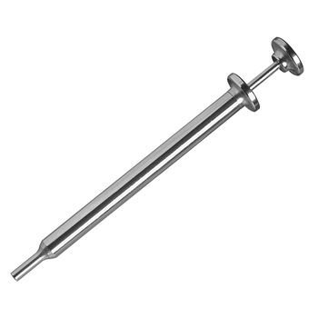

It's really not that difficult, but it is time consuming - you need to work slowly to avoid damaging the switches and/or wiring.
First thing you'll need is a Molex pin extractor, this is the type I use:
Then it's a matter of carefully sliding the switches off a little, carefully fishing the wires out through the opening under them, repeat. The wires are taped together inside the 'bars, so you usually can't fish them out one at a time. A small hooked tool will help ease them out. Lubing the heck out of the wires with silicone spray will help too.

FWIW I have a set of original switches carefully removed from a 78 T3. Needle nose pliers will work to compress the Molex tabs so the wires can be removed from the plugs and bars...
The tool I showed also works on the sockets, something needle nose pliers won't do.
