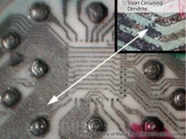

Another possible outcome is the formation of dendrites -- metallic, crystalline, fern-like growths that are deposited molecule-by-molecule on the board between charged conductors. As they grow, dendrites make temporary short circuits increasingly likely when condensation forms, since the distance between the circuits to be bridged decreases. Ultimately, assuming the PCB continues to function long enough, the circuits will be physically connected by the metallic bridge of the dendrite, causing a permanent malfunction. Here is a photo of such a short-circuiting dendrite on a PCB (source: www.multisorb.com/files/9113/4315/2180/article-moisture-in-electronics.pdf).
The Griso Digitek dash is particularly vulnerable to short circuiting of all types because of the very small pitch of the layout: the conductors are very close to each other. (The small pitch was remarked upon by a web guru called Techrat1, who will be introduced more thoroughly later.) The small pitch means greater amperage short circuits through the electrolyte can occur at lower voltages, and that dendrites have shorter distances to bridge.

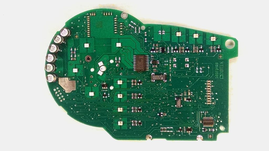

Layout of the Griso PCB
Here are photos of the upper and lower surfaces of the PCB in my dash.
Most of the interesting stuff is in the lower photo. The white circle (3) is the tachometer needle stepper motor. Above it is the pin connector (4) to the Griso wiring circuits. The large gray rectangle toward the lower left (2) is the Fujitsu CPU. At the left edge of the board is the ribbon connector terminal (1) for the LCD display. To its right, the small rectangle (5) is the serial EEPROM, a memory unit that holds the parameters we set on the dash and also stores the odometer mileage record. At about the four o'clock heading from the stepper motor, right on the edge of the board, is an array of ten unused connector terminals (not numbered). These are a programming interface to the CPU.
I didn't figure all this out on my own. The information comes from an exploration of the Aprilia SR50 scooter's dashboard, done by user Techrat1 on www.apriliaforum.co m. (Here is the thread: http://www.apriliaforum.com/forums/showthread.php?180601-Digi-Dash-modding-or-repair/.) That dashboard is a simpler version of the Griso's, lacking the CAN bus, and also the air pressure sensor that will be an important part of my tale, visible as a twelve-sided shape just below and to the right of the stepper motor (6, above). Here is a photo lifted from his thread, showing the similarity to our dash:

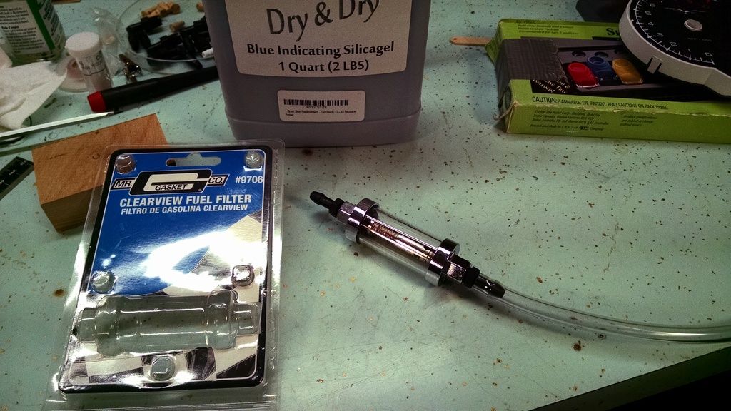

The Desiccating Breather
I decided on a clear glass fuel filter for the desiccating breather.
The breather is filled with color-indicating silica gel desiccant and zip-tied to the bundle of wires under the right gas tank wing. The right-side hose from the dash goes to the forward nozzle of the breather. The left-side runs in parallel along the same side and then loops back toward the rear of the breather. It attaches to a tee fitting which in turn is connected to the breather. The bottom of the tee is left hanging downward. The tee fitting has been modified so that the nozzle attached to the left-side hose is plugged; it functions only to seal that hose and hold it in position. The bottom nozzle has only a pinhole opening, feeding the breather.   The pinhole is the system's only opening to the atmosphere, and any air coming through it must pass through the desiccator on the way to the dash.
I purchased a 12v aquarium air pump to purge the system when it is being assembled and whenever the desiccant changes color, indicating it is exhausted or if condensation is ever observed.
Though I thought of permanently incorporating the pump into the system, and even bought an electronic humidistat-controlled relay, I decided in the end to make it a service tool that I insert in place of the tee fitting when needed, making a closed system in which the air is circulated through the desiccant. The pump is a loud little thing, and I wouldn't want it cycling on and off while I ride.

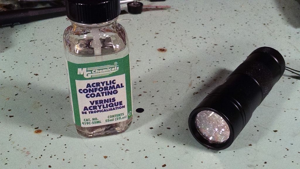

This part describes what's involved in putting a conformal coating on the Griso dash's PCB. It's an appealing approach to moisture-proofing, but the associated disassembly is challenging at points.
How Conformal Coatings Work
A conformal coating is a thin layer of a plastic applied to cover all suitable regions of a PCB. It is typically sprayed or brushed on as a liquid. The purpose is to prevent water droplets from collecting on the board, with the associated problems discussed in part 1. Interestingly, a conformal coating does not prevent water vapor molecules from reaching the PCB. As plastic, the material is permeable to water molecules. But if the coating is well applied so that it adheres strongly to the PCB, water molecules find themselves still trapped among polymer strands when they encounter the PCB, and so cannot collect together to form conducting droplets or pools.
It is important that conformal coatings be applied properly so that they do not bubble or otherwise become detached from the underlying surface when they dry. A thin coating helps to achieve this, and the military has a standard for these coatings requiring them to be about .003 inch thick. This kind of application would be hard to achieve without special equipment. However, hobbyists apply conformal coatings by hand, apparently with satisfactory results. I chose to use (I think) the most popular hobbyist material, an acrylic, shown here:
A comparison of different types of coating materials recommended this kind of product for situations like mine.
Conformal coatings are essentially invisible to the naked eye once applied, so a UV flashlight like the one in the picture is recommended for making sure coverage is complete. I paid about $10 for the UV light, and found it was money well spent.

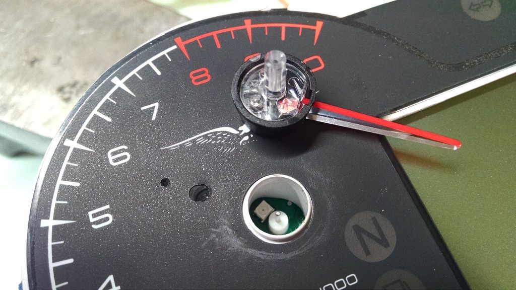

How to Remove the PCB
The first thing is to remove the complete dashboard with its clear instrument cover from its mounting on the fork. This requires no special instructions. The instrument cover can be removed from the the dashboard by prying gently on the closing tabs around the edges. There may be some silicon glue to separate, and similar glue should be used on reassembly.
Removing the clear cover exposes the tachometer/instrument faceplate material. At this point the tachometer needle needs to be removed. An instruction I read on the internet worked well: Grasp the hub of the needle between thumb and forefinger and pull up pretty firmly and steadily. The hub should come up by an eighth of an inch or so and then stop. At that point, twist the hub counterclockwise against its internal stop while pulling gently upward. It will slowly twist off. I've done this twice now without incident. (EDIT: Looking at the smooth needle shaft in the photo, I think there is a bit of magical thinking going on in this removal procedure. But it works.) To reinstall the needle, make sure to position it to read zero when the stem has been rotated counterclockwise to hit the stop. Then push straight down. The post seems like it could be damaged easily, so deliberate caution is required.
The next step in getting to the PCB is to remove the three screws that attach the top and bottom halves of its enclosure to each other. Two of these will be found by gently bending up the two corners of the tachometer faceplate. The third screw is located 31mm from the edge of the faceplate in the direction of the 6 thousand rpm marking:
[EDIT: I now think the faceplate could probably be removed by inserting a putty knife from the edge and prying up around the central needle housing. I didn't do this because I was trying to avoid removing the needle. Only later did I understand the needle had to be removed anyway for access to the PCB. So the following paragraph about drilling a hole might be ignored.]
A small hole should be drilled through the faceplate using a brad point Forstner or other suitable bit. Then the third screw can be removed. (The hole can be covered with a small circle of electrical tape on reassembly. By the way, the little bonus hole in the photo was my mistake, even after measuring twice.)
The top half of the enclosure can then be withdrawn from the bottom. Turning it face down on a table, it looks like this:
In the photo two copper-colored projections connecting the PCB to the LCD display below can be seen in the foreground. These must be desoldered in order to remove the PCB from the housing. Techrat1 remarks that these are not metallic connectors, but copper-plated fiberboard, and require great care in desoldering. Use either a desoldering braid or a vacuum solder extractor. I confess I broke one of them. I replaced it on reassembly with a piece of desoldering braid, infused with solder.
The ribbon cable connector at the left side of the photo needs to be separated. It works like other cable connectors, though Techrat1 also comments on its delicate construction. The black bar seen across the top of the connector in the following picture amounts to a long wedge which can be pressed back away from the joint using your fingers on either end, releasing the ribbon. Take a moment to observe which side of the wedge is the top, so that you can more easily reassemble it later.
Now the PCB can be removed from its housing by pressing the tabs on the periphery outward.
Inspection, Coating, and Reassembly
Once the PCB is removed from the dashboard, it would be a good idea to carefully examine both sides, using a magnifying glass if nothing obvious is seen. You're looking for corrosion of course, but also very tiny dendrites (as shown in part 1). My own dash looked like new when examined by eye, and I neglected to examine it with a magnifying glass until the coating was applied and the board was resoldered to the LCD connectors. Looking closely at the ECU's connectors (which I estimate have an on-center pitch of only about 0.65mm) I found one suspicious particle about 0.3mm in diameter nestled against one pin. It's under the coating now, of course. I think it's a flake of dandruff, but wish I'd looked for it earlier.
The PCB should be painted with the conformal coating using the small brush attached inside the lid. A complete, even coat is desired, remembering not to cover open connectors (e.g., the ribbon cable terminals and the pins of the multi-pin connector) or anything else that might be damaged (in particular, don't cover the air pressure sensor). Make sure to do a good job on those closely-spaced connectors emanating from the CPU and other modules. I found surprising gaps when I checked the coverage with the UV light, which I then corrected. The bottle recommends a single coat.
After applying the conformal coating to both sides (and letting it dry) reassembly is pretty straightforward. Replace the board on the housing. Slide the ribbon cable into the connector and then wedge it with the black bar (right side up). Solder the two connectors from the LCD to the PCB, remembering they are fragile and are only coated with copper, not solid. Replace the screws holding down the faceplate and apply a patch of electrical tape over the hole. Press the tachometer needle on carefully, as described before, but don't press it all the way home yet.
Once the dashboard top and bottom enclosures are assembled and the tachometer needle is replaced, but before replacing the clear instrument cover, it is a good idea to see if the dashboard is working and then adjust the needle. Attach the two connectors from the bike's circuits while the instrument is just perched on the triple tree, and then turn on the ignition, while holding your breath. If it doesn't work at first, try reseating the connectors. If the needle does not read zero after it sweeps up and down in its starting routine, pry it up and reposition it. Press the needle all the way down on its post when you are satisfied.
