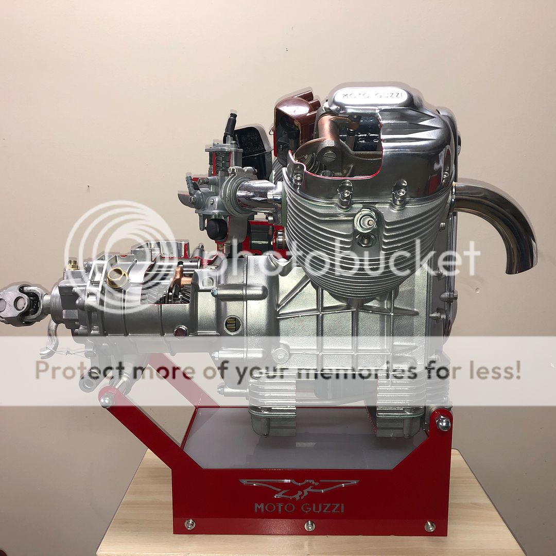

I have had some 1/8" steel plates laser cut with the Guzzi text and logo, I traced over a jpeg in AutoCAD and sent the files to a fab shop.
These two sides will be joined with a 1" x 1" steel angle to a 1/8" steel base plate and I plan on making up an opaque white plexi-glass light box to fit between the steel plate sides and back light the logo and the underside of the engine.

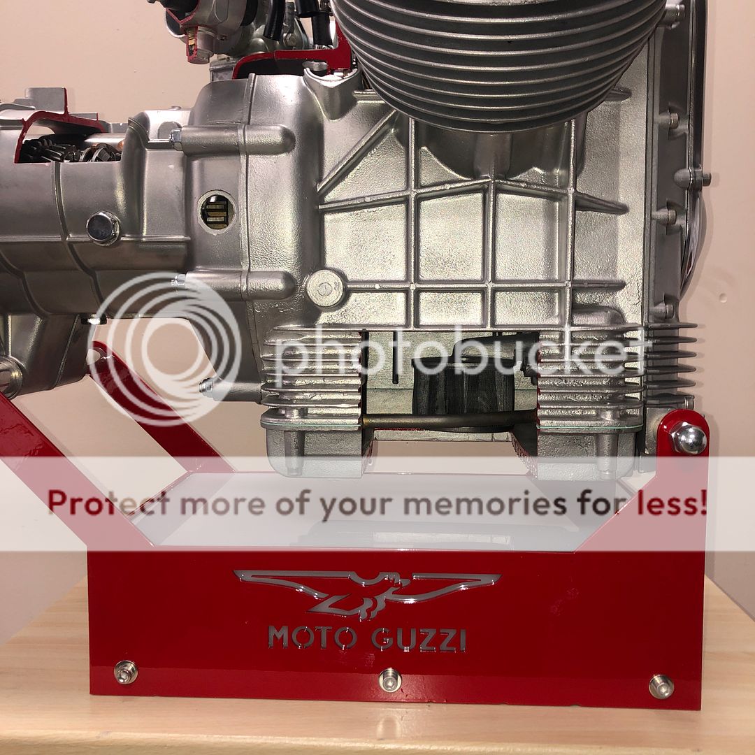

I finished the engine stand today, laser cut 3/16" steel plate, 1/8 Plexiglas top and side inserts. I will install a LED light strip inside the light box and run it off a 12v battery.
If anyone wants the CAD or pdf file of the side plates for the stand just send me a pm with your email address and I will share the file with you.

That is just amazing Jim. A real work of art. :thumb: :cool:
