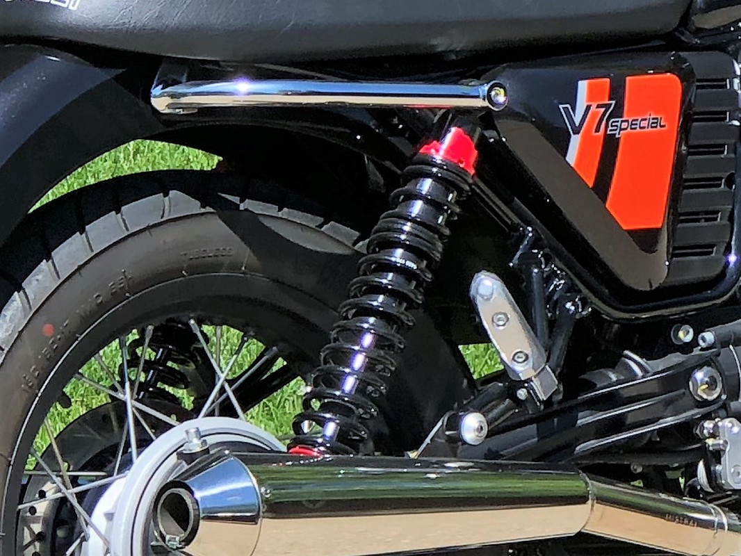

My backside knew within the first 10 miles on my V7 that a rear shock upgrade was mandatory.
I think both of the options shown would serve you well, and be a huge improvement over the stock shocks.
I installed Progressive Off Road shocks based on the recommendation received from Dave Richardson at Moto International.  They have to be mounted upside down to fit the V7, but this shock can be mounted either way.  The Progressives were in the same price range as the shocks you are considering
