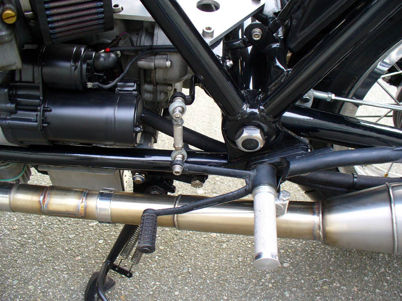

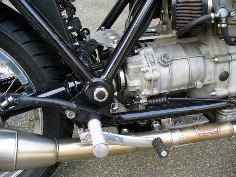

Agostini for 850 LM. Brake side like below. Cut original lever & make a new foot 'stub'. Works fine even with reduced leverage.
« Last Edit: December 13, 2021, 03:26:53 PM by geodoc »

Re: 850 T drum brake rearsets
« Reply #9 on: December 14, 2021, 09:46:37 AM »
Pete, those rear sets directly   above look nice and should be simple to fabricate...

« Reply #10 on: December 15, 2021, 08:32:00 AM »
I agree.  Should be able to make them for less than the Tarozzis, even with my time accounted for.
