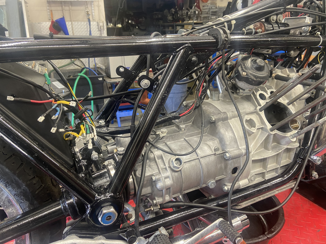

I recently refreshed a friends V7 Sport with the motor in the frame. I used NAPA aluminum Brightner diluted 2:1, (use a full face respirator with acid cartridges), before and after, you mist the cleaner onto the castings then after a couple minutes blast with a pressure washer and keep repeating until you get the finish you are after. I did this for years before I bought a vapour blast cabinet and fully disassembled the motors.
After
Online SIR REAL ED
  • Posts: 3038
  • uh.... it's personal....
  • Location: Forest, VA
Re: Cleaning & possibly painting a motorcycle engine as an assembly
« Reply #15 on: September 30, 2023, 09:08:33 AM »
After
Thanks Jim.
I can understand that cleaning up bare aluminum, but will it remove paint also?
That looks like a REAL motorcycle.  IMO, casting reinforcement ribs should ALWAYS be on the outside of the motor, where they can be appreciated!
Good luck getting over the vertigo.

Thanks to all who posted for all the great advice and sharing your knowledge.  After 2 rounds of Extreme Simple Green and pressure washing, the engine is "good enough" for my intended purposes.
The valve covers on these bikes always seem to have a lower grade of paint and finish than the visible parts of the engine, and the dirt stays there and bakes longer, so the appearance of the valve cover is not surprising.  It does clean up well with some brushing, but repainting will probably be part of the process at some time.
The following picture shows the stock paint on the DR head, while the cylinder has been painted with Dupli-Color # DE1651 Cast Coat Iron.  It has held up very well for about 10 years now.
« Last Edit: October 04, 2023, 07:04:37 AM by SIR REAL ED »
