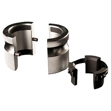

I do not but I can tell you a piece of 1-1/2" PVC schedule 40 pipe will do the same thing for about $52 less.

  Cut the pvc tubing lengthwise and it becomes adjustable for fork diameter.

My question is how one driver can install seals from 32 mm to 47 mm? How does that work? Something like this one made by "Stockton".
 :+1
see the tube at the top of the below image:
Plenty of descriptions on the internet as to how to make and use this, if it's not already self-explanatory from the picture.
http://www.amazon.com/gp/product/B0089GM3ZW/ref=pd_luc_rh_sbs_01_03_t_img_lh?ie=UTF8&psc=1
Oooops...
Charlie,
That is the one that I bought...I have only used it the one time so far and completely forgot about the "one size fits many" plastic driver thingy.   ::)

I use A rubber mallet and or wood interface until I get even with the fork slider. I then take a socket invert it so the solid end faces the seal and genteelly tap it into place.
Never ruined a seal yet. But I've only done it 3 or 4 times.  ;D

Lube first. A paint stick and gentle taps working around the seal. No damage for 40 years.

For WP, Ohlins and other forks of the male slider sort, PVC pipe will not work. If all you ever work on are "right side up" forks, then a section of PVC would be fine.
I was not aware of this.  Please elaborate.  Isn't a USD fork the same as an RSU fork, only, inverted?
RSU forks don't normally have anything at the top to "trap" a PVC driver. USD on the other hand have axle and caliper mounts at the bottom, so a solid tube driver (vs. split) would be trapped.
