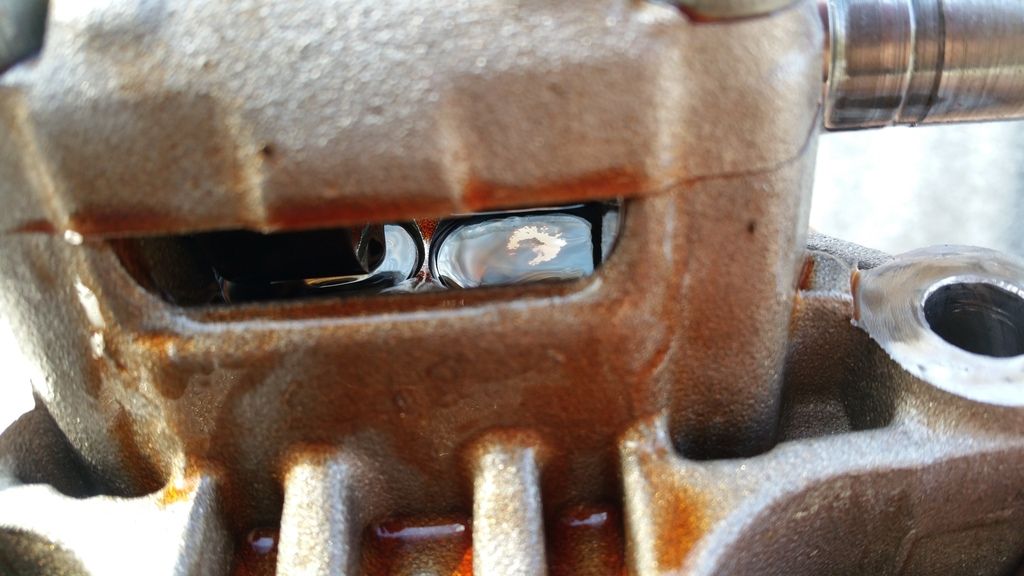

You have to pull the cam box and look inside.
At only 6000 miles, it may be fine. But it will eventually fail.
This is one at about 8000 miles from a 2012 Griso.

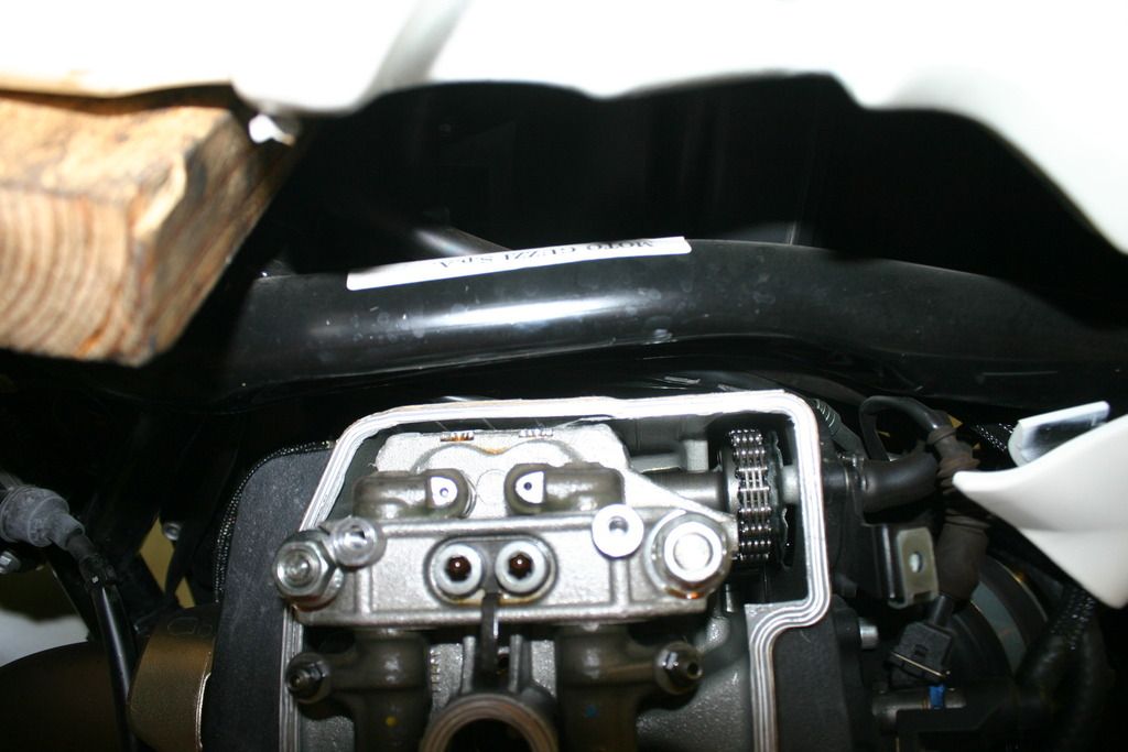

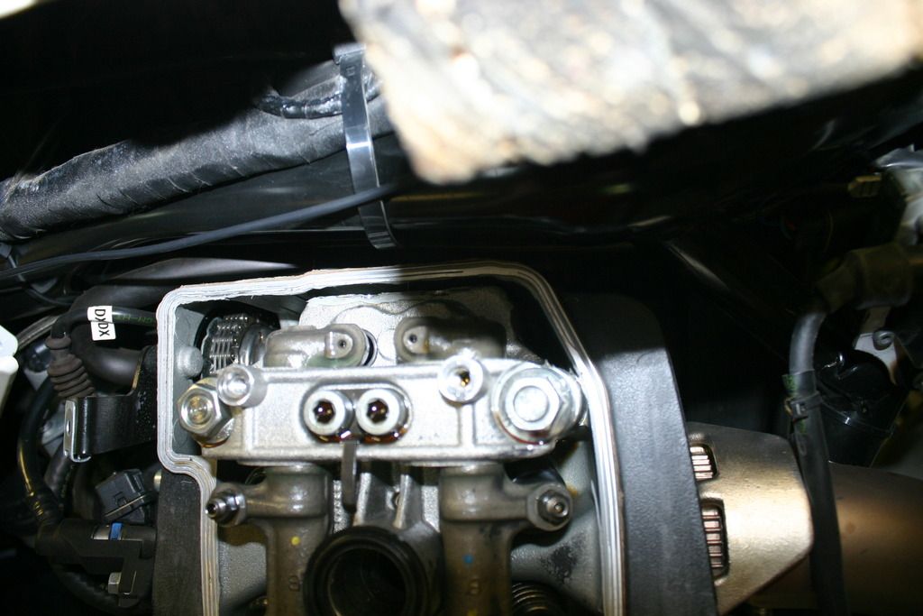

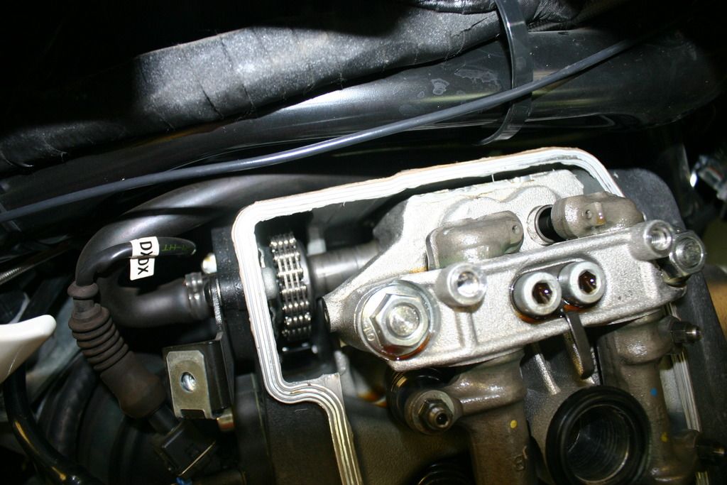

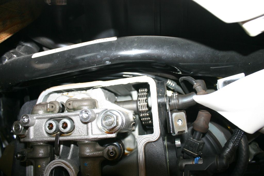

The pictures you have posted don't really show anything other than the tops of the cam boxes. No wonder Piaggio said they were OK! As OMG said you need to pull the boxes out to see any damage. The picture of the cam lobes and tappets from my bike show the damage. Any missing DLC like on the upper tappet in the picture is enough to be a fail. Also note overheating discoloration on the cam lobe. Its not if its when for all flat tappet engines.
This amount of damage was accepted by MG for repair and I now have rollers.

Hi Esmurrell. Those photos you posted, are they the only ones your dealer submitted?

I just spoke with my dealer and these are the only pictures they took.  They tell me that if clearances on the valves are off at all, that's the tell tale sign the look further.  In my case, the clearances were spot on and they had no reason to look any further.  This is the reason I asked the question on this forum because I don't know what to look at or for and need some guidance from folks that know more than me.  My dealer did also say that he will make another run at Moto Guzzi for me to see if he can get this authorized as I don't want problems down the line.  I'm open to more feedback from others.

The surprising thing is ......... how could Piaggio/MG look at these pics and say 'things are ok?'  Change dealers asap.
