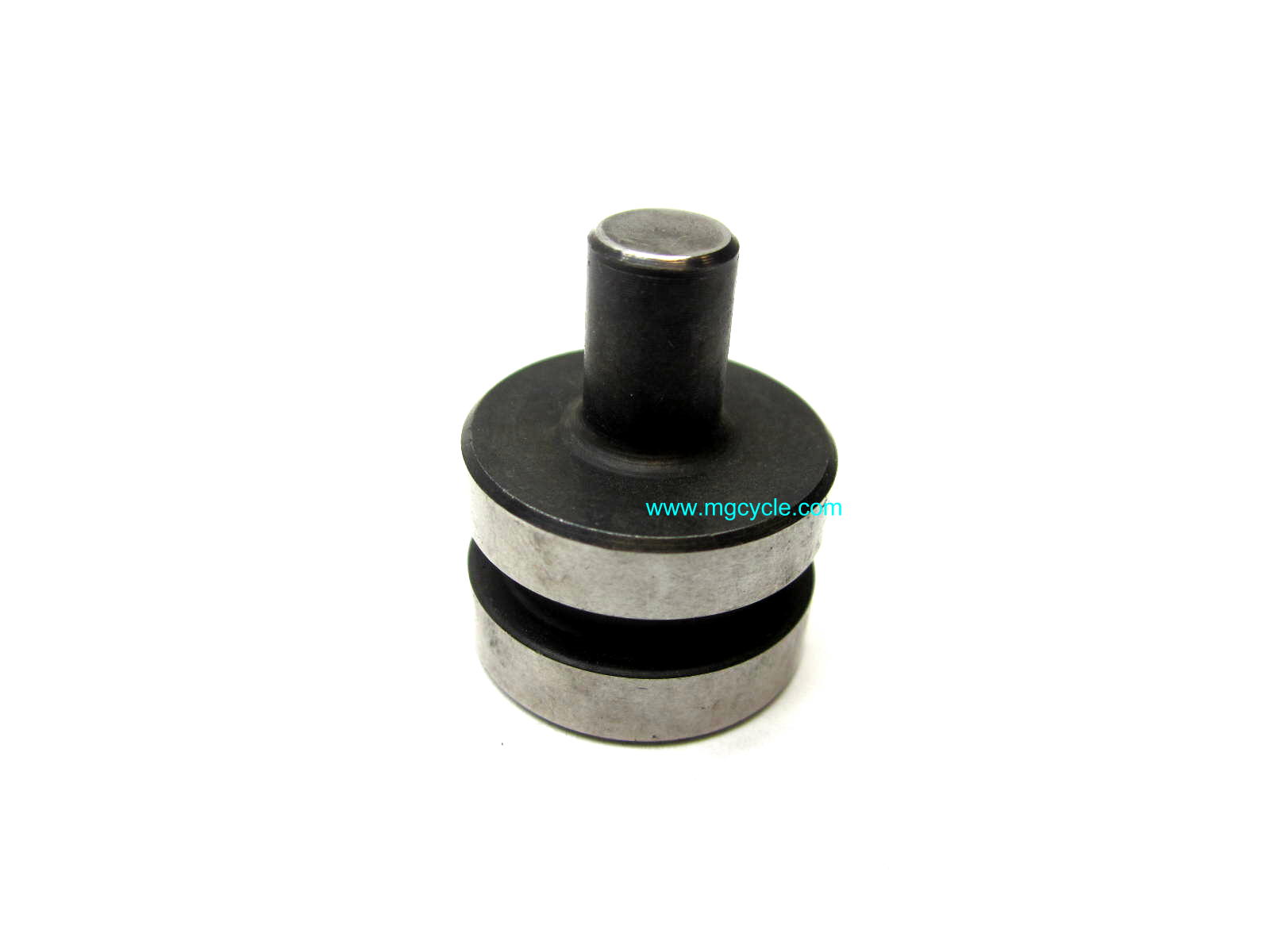

A few questions:
1. what clutch plates are installed? SD-TEC?
2. How far recessed is the throw-out bearing outer body? This piece:

Yep. I've run into this issue several times when using the SD-TEC plates. I either insert a steel ball between the clutch pushrod and throw-out inner body (down inside the inner body) or make a longer pushrod.

I give up trying to post a picture but the plunger is in more like 9mm. I'll look and see if one of my 8mm bearings will fit.
  • Posts: 15170
Re: New clutch at the outer adjustment limits
« Reply #10 on: April 15, 2016, 07:18:11 PM »
The ball goes in the other end of this piece, the inner body:
and the hole is 6 mm.
The ball does not go in between the outer and inner bodies, only the needle bearing goes there.

Buy a cheap ball bearing with the size of ball you need, crush/crack the outer race in a vise and harvest the balls. That's what I have done.
