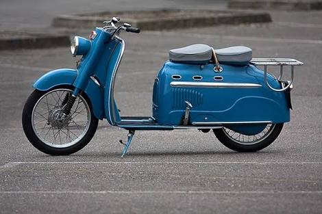

That variable belt drive was used
on some scooters and may well be still. Our French teacher at college had a wierd Manurhin ?? Scooter that used it.
https://encrypted-tbn1.gstatic.com/images?q=tbn:ANd9GcRKrh-WU0pT5f7FuRdovVuYJ1RI26KGJDaxn8JbNLMvlacA4bI7IeoBks79fw
