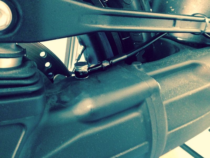

The mod I haven't seen posted yet (did I miss it?) is the breather valve from the CARC. Both sets of NTX riders I bumped into stated the breather can/will allow water into the rear end while fording deeper streams. Anyone else have/know of this issue? Seems an easy fix and I was placing that mod at the top of my list.  :wink:

Goodridge brake line and fitting, banjo bolt to fit the breather vent.  Mine just tucks up near the battery under the seat.

Thanks! That's the mod I was referring to. I have that one covered in a spares box somewhere... :coffee:
