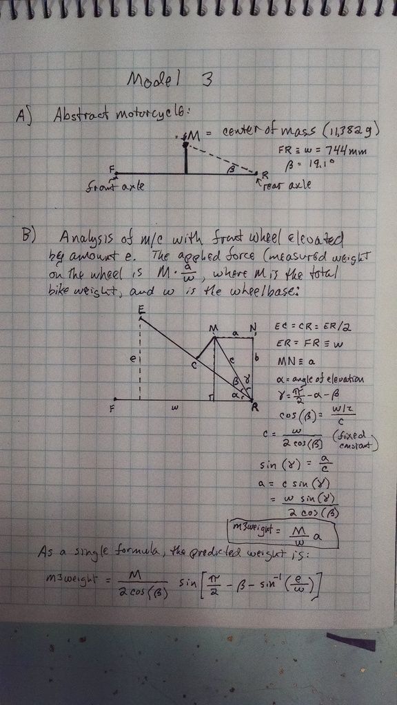

I looked at my earlier analysis and decided that the approach of calculating a torque for half the mass of the bike around a fixed pivot was, well, bogus.
So I did a satisfactory analysis by modeling the motorcycle as the abstraction seen at the top of this page:
All the mass (the total weight of the bike) is concentrated at point M, which is attached by a vertical bar to another bar that ends at the front and rear axles. Both bars are massless, and the axles are points. The angle beta is the angle between the center of mass M and the rear axle, which I measured by finding the point where the bike balances on its rear wheel. This, as mentioned before, is not achieved when the bike has been rotated up by 90 degrees, but instead when it has been rotated 19.1 degrees less, which is the numerical value of beta for the bicycle being used to model a motorcycle.
In part B the abstract motorcycle is elevated at an angle alpha above the horizontal. The applied force (weight) at the front axle F is equal to the total mass (M) times the ratio of the moment arm a = MN divided by the wheelbase, w. (This is a point mass model, instead of the distributed mass moment (integral) model proposed before.)
The page shows calculations of angle and line segment lengths using trigonometry and the given values, namely the wheelbase, w, the elevation, e, and the angle beta to the center of mass. The result is a single equation that gives the predicted weight on the front wheel as a function of its elevation:
             m3weight = M / (2 cos(beta)) * sin[pi/2 - beta - arcsin(elevation / wheelbase)]
The following graph shows how well the model does in reproducing the previously obtained measurements:
There are some interesting features to the graph. The heaviest dashed line represents the model 3 prediction, which is close to the observed values on the whole. It correctly predicts the observed weight when the elevation is zero, and also the correct front wheel weight of zero when the bike is at the balancing point [which a calculation from the measured angle (19.1 degrees) shows occurred at 703 mm of elevation of the front wheel]. The model doesn't do as well in predicting the weight when the front wheel is 248 mm below the horizontal (hanging off the end of the workbench, resting on the scale), for no reason that I can think of.
The most interesting part is model 3's predicted value when the bike is 90 degrees from horizontal, which is past the balancing point. The predicted weight on the front wheel is negative, about -1.6 kg. Of course I cannot directly measure this negative weight with my scale.
This implication of the model can be understood by bringing to mind that the total measured weight on both wheels together must be equal to the motorcycle's actual weight (as measured previously in a basket, at 11382 g). If the front wheel has a negative weight, then the rear wheel must have a measured weight that is greater than the motorcycle's actual basket weight!
This is easily confirmed by locking the rear wheel, placing the bike on the scale and rotating it to 90 degrees, which takes some forward-directed pressure from one's hand to keep the bike in position, of course. Doing this as carefully as I could, the reading on the scale was about 12.9 kg, or 1.6 kg greater than the bike's actual weight, even though I was very careful not to add any downward pressure.
Where does the extra apparent weight on the scale come from? It must come from my forward-directed pressure keeping the bike from falling backward. Newton's third law says that every force (my hand pressure) is countered by an opposite and equal force. The only available point on the bike through which that opposing force can be applied is at the tire's contact patch, sitting on the scale, and that's where it is coming from. There is a vector analysis that someone who knows what they're doing could perform to make it all balance out, but I could feel I was exerting about the right amount (1.6 kg, perhaps) of pressure with my hand, and I could see the scale measure the extra 1.6 kg of counteracting force in the difference between the apparent and true weights. My son was somewhat impressed, for once.   :cool:
In any event, this new model is a good one. It reproduces the data, and makes out-of-sample predictions that are confirmed. I plotted the extra 1.6 kg of apparent weight as its corresponding negative value in the plot, at the red triangle. This is an actual, indirect measurement of the counter-intuitive "negative weight" prediction of the model.
The upshot is still the same as before. Using a scale under one wheel will produce more of an error in calculating the total weight (as the sum of both wheels separately measured) than I figured from model 1, a simple, erroneous application of my  so-called Sine/Cosine Theory. Again, this is because the action is occurring in a steeper region of a trigonometric function (now represented as a sine). The error is probably in the range of a pound or two, I would guess, though I don't have any actual motorcycle measurements to base the guess on. The Australian still provides the best empirical evidence.
