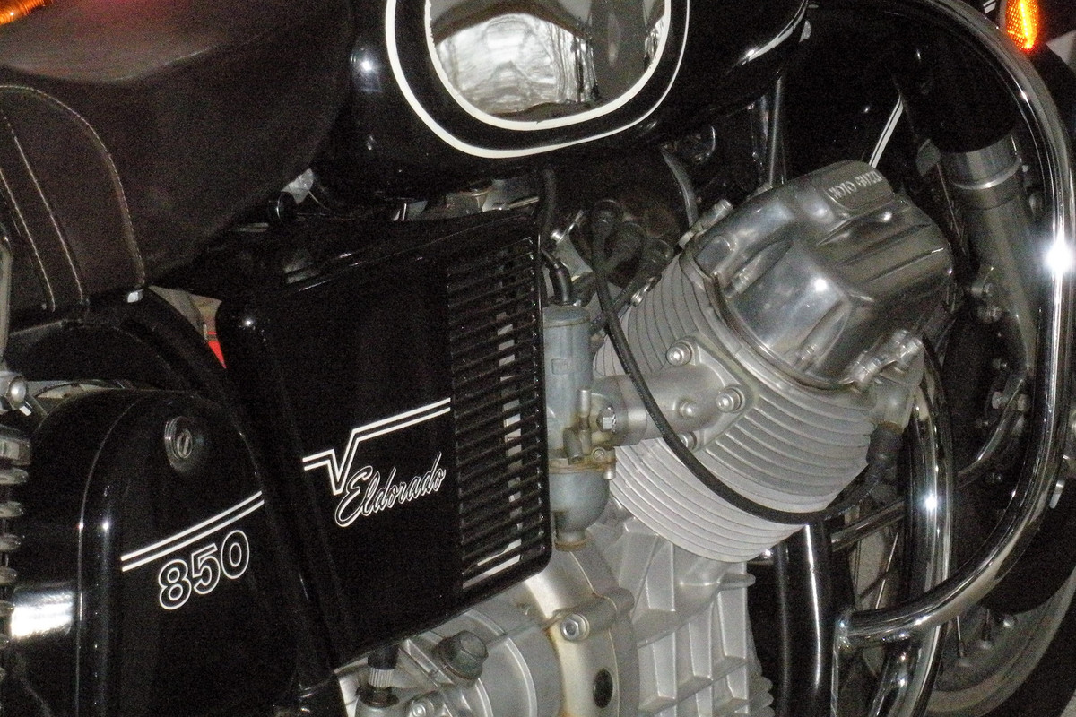

Well, I installed the new Gilardoni Nykosil cylinders, last weekend. The install went fairly smoothly, and I was able to get it all done on the frame. With some help from my dad, of course.
For prep, I pulled the tank, side covers, exhaust, and front engine cover.
Plugs and valve covers pulled, and about to get into the meat of the project.
Pulled the rocker arms, pushrods, and girdles, and removed the heads. Found that I had been getting some blowby, due to a head gasket that had gone bad.
Pulled the old cylinders and pistons, next. On the advice of my dad, I stuffed a rag down into the case on each side, just in case I dropped a circlip.
After examination, the chrome had definitely started to wear thin on both cylinders. The good news, though, is that there was only a tiny amount of actual flaking in one cylinder.
free web image hosting
New pistons and cylinders installed. I found it extremely easy to work the cylinders over the rings after installing the pistons and wristpins. No issues at all. I know some say they find it easier to do it the other way around, but I can't imagine it being so.
Thoroughly cleaned the heads and valves, before reinstalling. Then reinstalled the girdles, pushrods, and rocker arms, torqued the heads, and reset the valves.
After that, it was just throwing the valve covers back on, reassembling the other components that I had taken off for prep, and putting in some fresh oil. While I was at all of this, I went ahead and replaced the intake gaskets, oil line washers, and exhaust washers. Took her out for an hour or so, after reassembly, and she runs great! Thanks to everyone who gave me tips and advice on this job. This forum really is a great resource.

You'll need to retorque the heads and adjust the valves several times over the next 500 miles.
Offline JC85
  • Posts: 616
  • Location: Chanute, KS
Re: '74 Eldorado Police Model - Giving a family heirloom new life
« Reply #13 on: June 12, 2019, 08:44:06 PM »
:thumb: :thumb:
I was aware that they would need retorqued, and my dad recommended that I ask how often. Thanks for the info.

My normal retorquing schedule:
- assemble engine except for rockers, torque head nuts to spec.
- let sit overnight, retorque, finish assembly.
- start engine and run for 15-20 mins., let cool back to ambient temp., retorque.
- 5 complete heat/cool cycles (up to operating temp., back to ambient), retorque.
- 500 miles, retorque.
- 1000 miles, retorque.
I use the higher figure of the recommended spec. - 32 ft.lbs.
