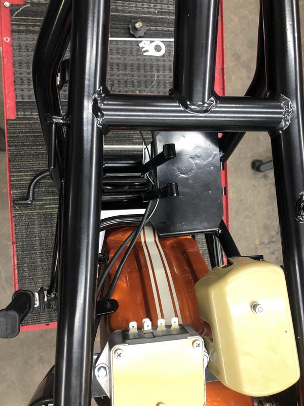

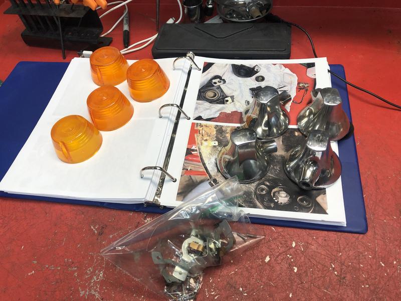

A little progress this week, emptying out a few more bags of parts,
cleaned up the Aprilia signal lights, buffed up the aluminum with rouge polish, had the steel parts zinc plated or chromed

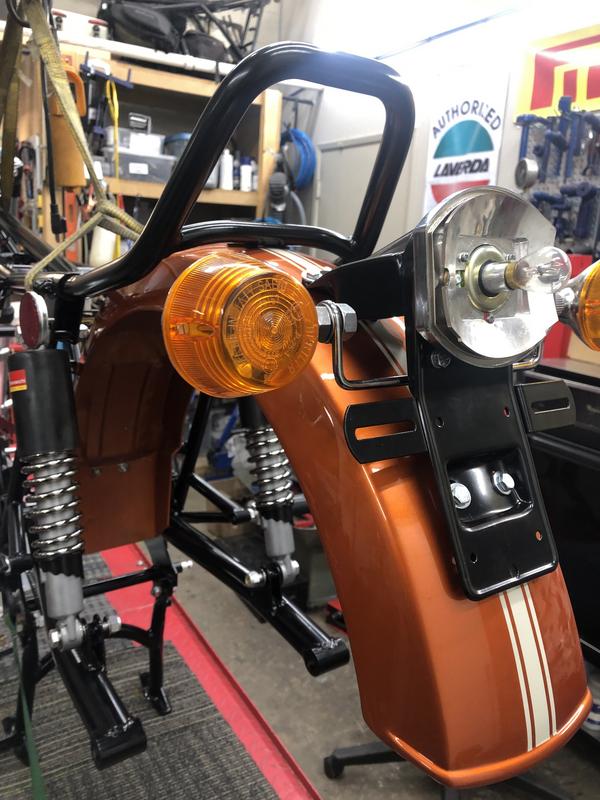

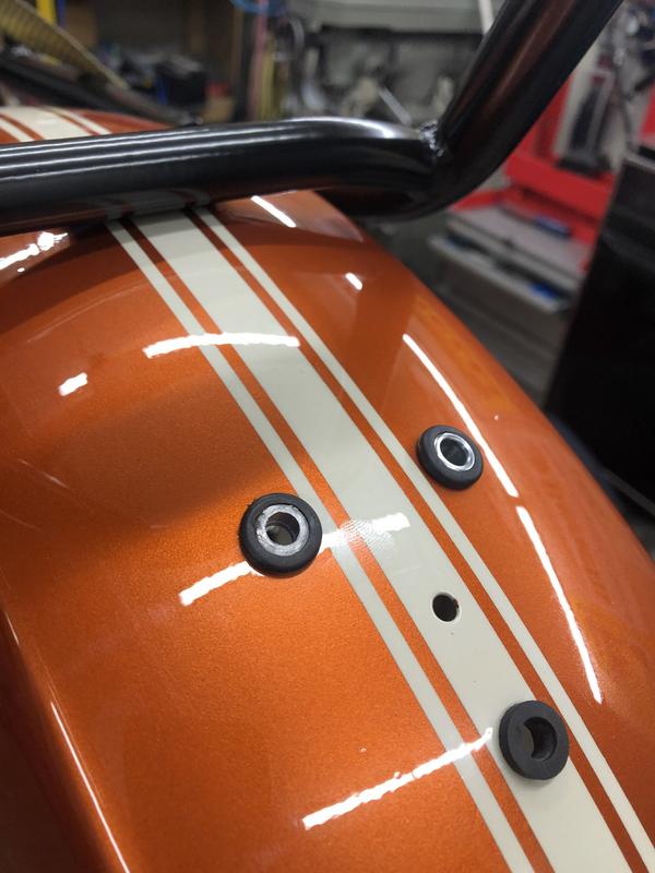

New rubber grommets and steel sleeves for the tail light bracket
I powder coated the rear bracket and save the original CEV tail light assembly
I made up a sub harness for the tail light and signa lights and used pvc tubing from British Wiring
I found a pair of the stock air boxes, getting rid f pod filters and going stock
cleaned up the fuse box, found a NOS lid and reused the regulator / rectifier

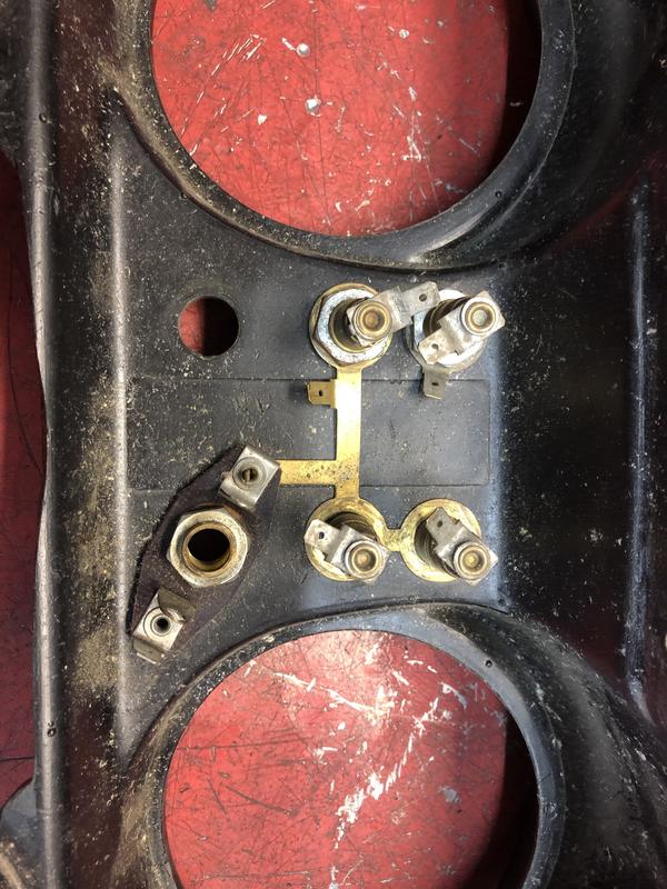

I bought a used dash, it was cracked but the idiot lights are all good, swapped them to the repro dash

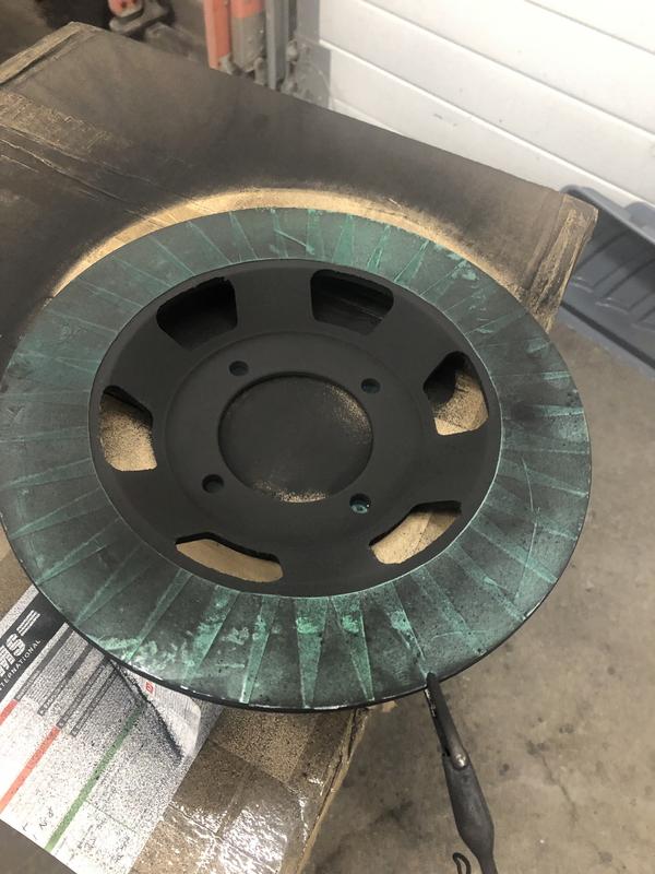

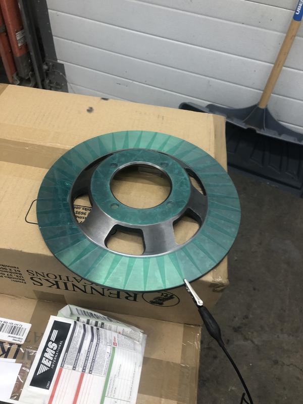

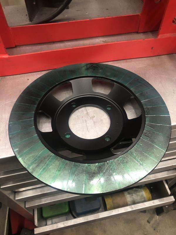

I had the one original Brembo disc measured up, there was a deep rust groove on the back side of the rotor and too deep to turn the rotor.
Bevel Heaven sent me a pair of new Brembo rotors, not cheap but I decided to add a rotor and go with a pair. The new rotors arrived bare streel, I used my DIY Eastwood powder coat gun to apply a coat of flat black powder. Eastwood sells the heat resistant masking tape as well as powder and the electrostatic gun.
Masked and washed clean with acetone.
A light coat of powder applied with just a couple psi pressure
Flip the rotor over and dust the other side then into an oven heated to 390 F for twenty minutes
Remove from oven and let cool
Then peel off the masking tape
I use an old used wall oven that I fit into a simple 1" HSS frame, I get these ovens for around $50 or less and when they die on me I just pick up another used one on Kijiji.
DIY powder is so easy, no fumes, easy clean up, super durable finish and cheap once you invest in the powder gun and a simple oven.
« Last Edit: December 29, 2019, 05:54:57 PM by canuck750 »

Re: Gone to the Dark Side - Ducati 860 GT
« Reply #192 on: November 20, 2019, 09:13:13 PM »
Did you actually hand-cut all those gores in the tape so that it would go on without bunching and wrinkling?   Or is there tape that's made to lay down in a circle?   :huh:
This is a great illustrated narrative.
« Reply #193 on: November 20, 2019, 09:25:42 PM »
I just lay the strips of tape down with one hand and trim them with a sharp xacto blade around the outer edge. Once I have laid down the whole surface I scribe cut the inside circle using the lip of the rotor surface as a guide. Only takes about 10 minutes to mask both sides of a rotor. The tapes is laying on top of the lower piece, just straight sections. I just press down the tape with the smooth plastic handle of the knife.
This is the heat tape I use from Eastwood, I have a couple widths for different jobs
https://www.eastwood.com/hotcoat-high-temperature-polyester-masking-tape.html
The powder gun I have is the cheap one Eastwood sells, I have had it for at least seven years and it still works great
https://www.eastwood.com/eastwood-original-diy-powder-coating-gun-starter-kit.html
If you haven't tried powder coating I urge you to give it a shot, no runs or drips, no fumes, and super tough finish. The smallest air compressor will be fine, only 2 ~ 4 psi required.
Residue powder just sweeps up.
« Last Edit: December 21, 2019, 06:27:18 PM by canuck750 »

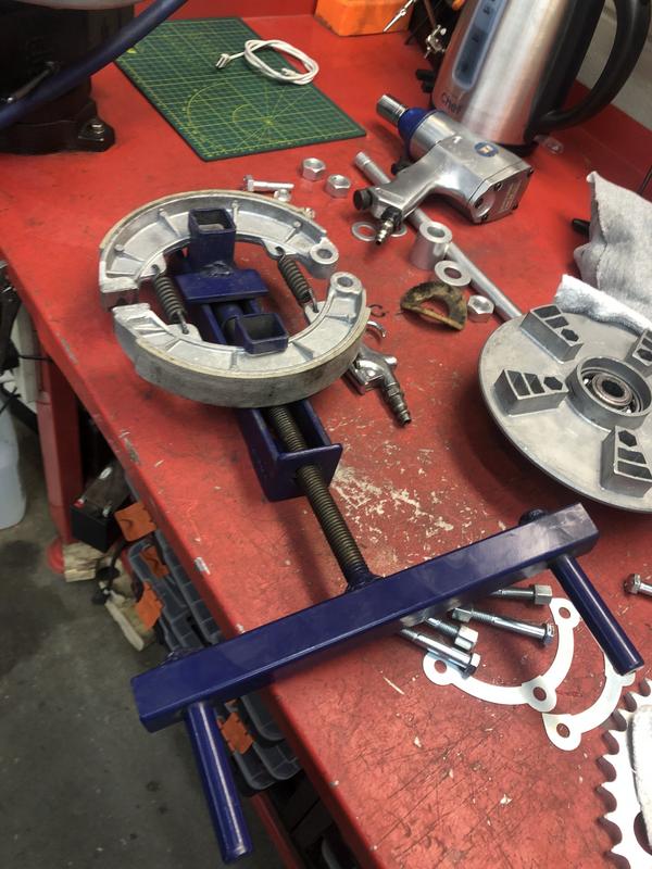

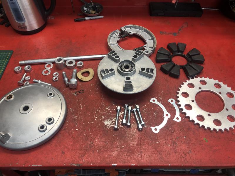

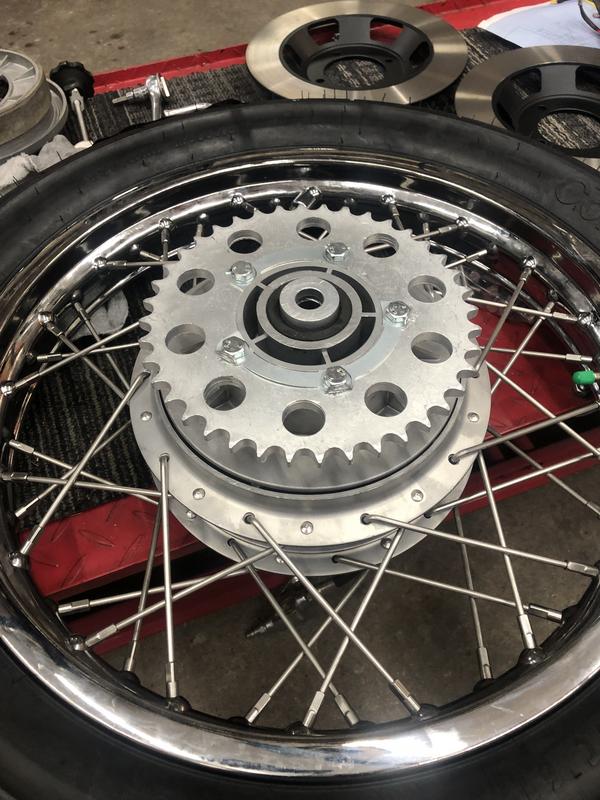

The bike shop called to say the tires were in and mounted on the wheels. I went for Continental front and back.
First to get the rear brake assembled, new bearings in the hubs.
the drum spreader I made years ago for my Eldorado rebuild still comes in handy
and the sprocket carrier, rims have been re-chromed and Buchanan's made me new stainless steel spoke kits.
rear wheel mounted

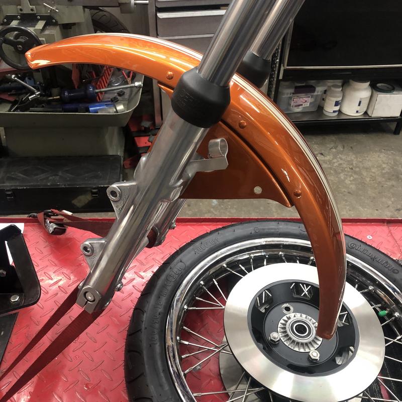

Front fender on

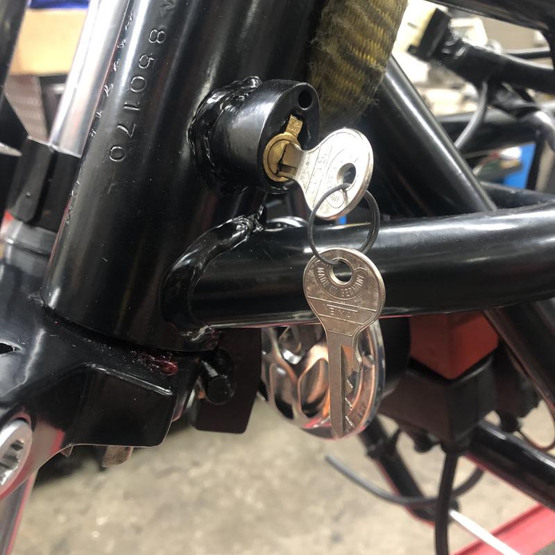

installed a new steering lock

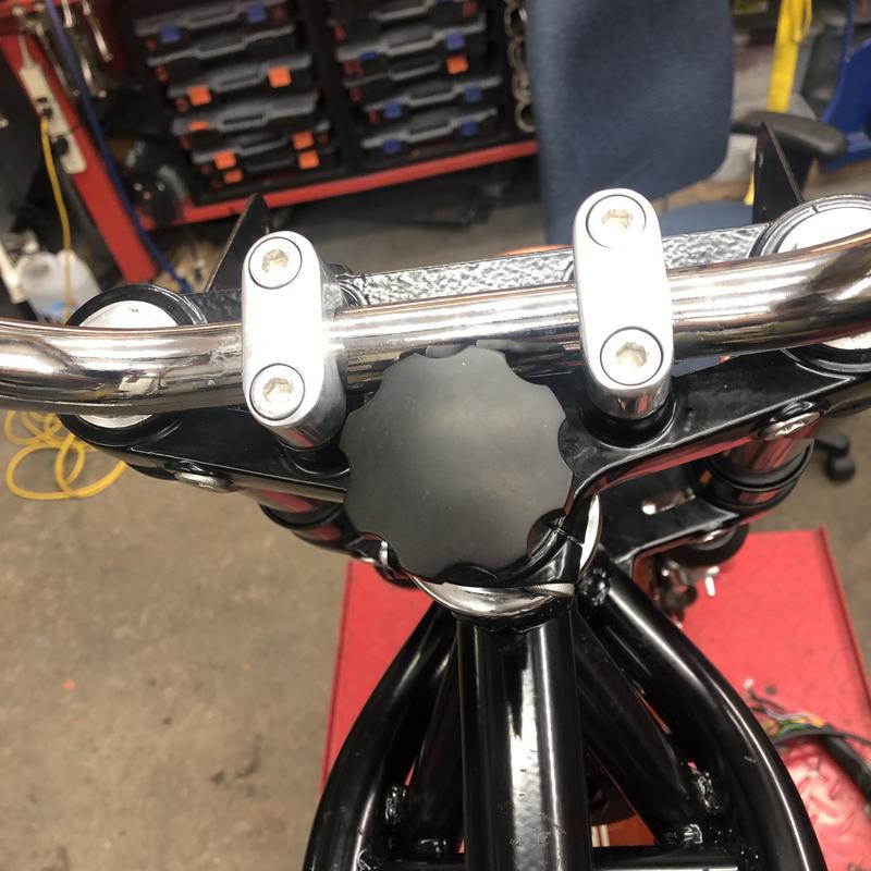

Thanks Chuck, I am really enjoying getting to know this Ducati
I bought a cheap die off Ebay from China for under $20 (free shipping), there was a flat spot on the stem that needed to be recut
After a couple passes off and on the stem was good
The repro Ceriani top stem nut is a 'tight' fit, had to oil it and work it on and off several times. The O.D, was also too big, turned it down in the lathe
Top clamp fitted, stem nut set and steering damper back in place
and the underside of the friction damper

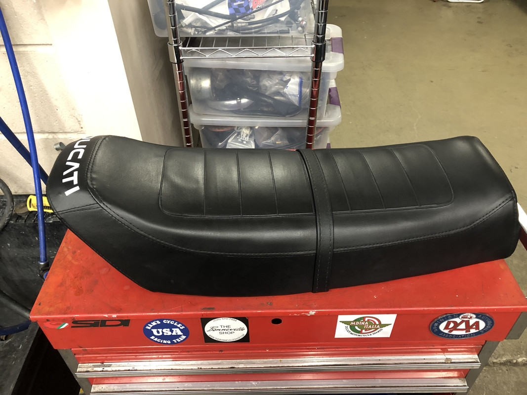

I dropped the seat pan, original foam and repro seat cover off at an upholstery shop today, hope the repop is a good match.

Is the device a relay or some other kind of device?
Thanks in advance for any guidance, did i mentions I really struggle with all things electrical?

Are you sticking with the stock master cylinder with the second caliper up front?
Also, does the second rotor just go right on the hub and line up with the second caliper, or is a spacer required as it was when I added the 2nd disc to my Eldorado?
That front end looks to be the same as my 750GT.
« Last Edit: November 24, 2019, 05:03:46 PM by jas67 »
« Reply #203 on: November 24, 2019, 05:07:45 PM »
Wow, looking great, Jim.   I LOVE the orange paint!
Yep using the stock Brembo master cylinder for dual discs, it was reportedly too much for a single caliper but better with a pair - its the same master cylinder and caliper set up on my Laveda SF and Guzzi 750S.
The right hand caliper bolts right on to the stock fork leg, it was designed  to take a pair and was stock on the electric start 860 GTE.
« Reply #204 on: November 24, 2019, 06:25:53 PM »
Thanks.
I know the 750 Sport and 750SS both had dual discs up front, so, I figured they just used the same hub and fork across the board.
I think I'll be adding a second disc over the winter.   It definitely brakes better with a single than the Eldorado did with a single, but, it'd be nice to get it closer to braking like a modern bike.
The stock master cylinder on the Eldo was WAY too big for a single caliper, require a LOT of force to actually stop the bike.

I dropped off the powder coated seat pan, original seat foam and a reproduction seat cover on Friday noon, got a call today its done! wow talk about fast service.
What a funky design... so 70's Italian, sharp edges abound :grin:
I got the seat cover on Ebay, Thailand supplier$60.00,  came with the strap as well, nice quality, they sell complete low back style seats as well
Rubber bumpers pads (rectangular and round style) from Bevel Rubber in Australia
https://www.ebay.com/itm/DUCATI-GT860-GT860-860-GT-SADDLE-SEAT-COVER-ZALA/223727502967?ssPageName=STRK%3AMEBIDX%3AIT&_trksid=p2060353.m2749.l2649
