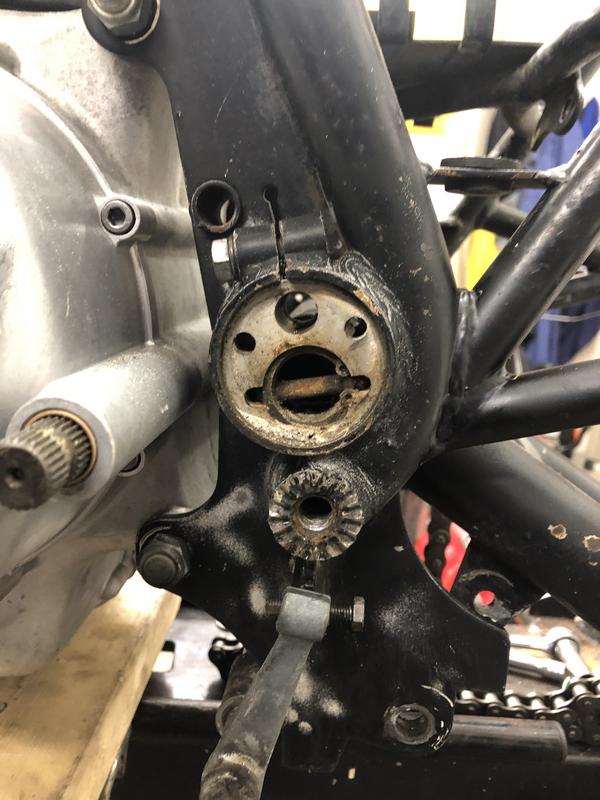

I do like the cam adjuster on the swing arm pivot for tensioning the chain, not sure how practical it was in use?

If you were to disassemble the bottom end for some reason, its actually not particularly hard to work on but takes some patience.  The crank and transmission shafts are shimmed in the cases like a lot of other older bikes, nothing too difficult if you keep the case gasket and compare thickness with the new one for reference.  Best to use the same thickness gasket if you can.  There's likely no need to mess with the bevel gear shimming but if you do decide to take a look at that for some reason, it's not rocket science on a square case engine.  I think you'd be amazed at how straightforward the whole thing is in relation to rumors from people who have never actually touched one. The sole really challenging part is the crank and rods assembly: if you need to address the rod bearings the crank is pressed apart, pin, rods and bearings are replaced with a new kit, and then the assembly is pressed together and aligned.  I did that myself but it's arguably better to give the crank assembly and a new rod/bearing kit to somebody who is familiar with built up crank alignment.  It's similar to 1970s Japanese fours or two strokes, but the parts and press fits are bigger and heavier.
It works OK.  This feature was introduced with the 860GT frame and carried on to some later bikes including the Darmah.  The very last Darmahs had both the eccentric adjuster and the conventional axle adjuster setup, but I think this was because Ducati was using up old stock parts to build the bikes.  In the 1983 time frame Ducati bike production was nearly shut down, they were mainly building Diesel engines for VM.
The more traditonal bevel Ducati chain adjuster setup with axle plates turned from hexagonal bar stock was BTW designed by Seeley, included in race bike frames done by Seeley under Ducati contract, and then adopted for production.
It does make it downright easy to adjust the chain with the added bonus that the wheels stay in alignment. Or out of alignment, depends on what day of the week the frame was made!  :evil:
This adjuster lived on for many years, my 750 Paso used an eccentric but those were in the wheel axle instead of the swing arm pivot.

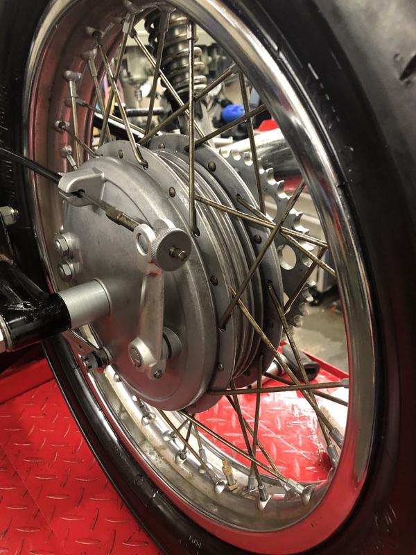

When I get a bike like this tired 860 GT I like to go through it from end to end to catalogue what it will need. I knocked out the wheel bearings and put the wheel wheel in my Vapor Honing Technologies 'Weekend Warrior' blast cabinet. After knocking the corrosion off the steel rims, steel pokes and alloy hubs they look fine, just need replating.
before cleaning
and after, coated with ACF 50 to stop corrosion until I get around to restoring this bike and a shot of paint on the rotor centre
Getting a Vapor blast cabinet was probably the best tool I have ever bought.
